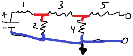

How exactly do you tell if two elements are in series or parallel? I know that if two elements share two of the same extraordinary nodes then they are in parallel:
But in this example I do not see that. I know for certain that the answer for Rt is:
[ ( (R1 || R2) + R3) || R4 ] + R5

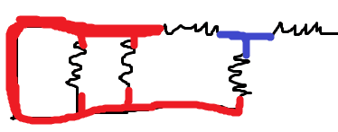

To find RThevenin you must short-circuit the voltage source. Do that and redraw. See if things make sense then.
Oh okay, that makes sense now, it would look like this:
And so the reason R3 is in series with (R1 || R2 ) is because they do not share the same two extraordinary nodes, right?
The drawing is not quite right. You are showing that R1 is being "shorted out" which is not the case. When you short the voltage source, you simply replace it with a wire.
You are right about why R3 is in series with R1||R2.

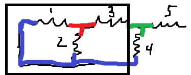

Right, that makes sense, here is my drawing now, which I think is correct:
So in this drawing, the reason R3 is in series with (R1 || R4) and then that whole quantity (enclosed in the box) is parallel with R4 since they both share the Green and Blue nodes. R5 is then in series with all of this since it does not share any other nodes with the circuit other than the Green one.
Instead of "(R1 || R4)", you mean to say (R1 || R2).
Other than that, you are correct!
