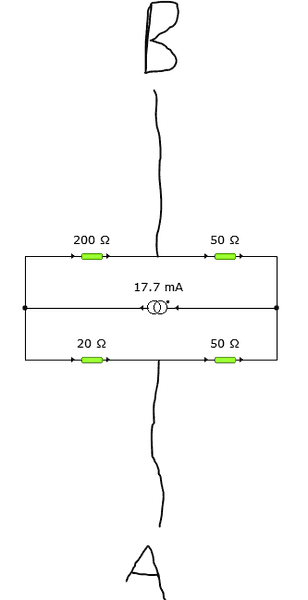

What's the equivalent resistance between point A and B?
16 replies · 3K views · last reply
oliverlines1234567
Simple as that, I've uploaded the image. I don't really care about the exact value, I would prefer just to know the method. So how would I find the equivalent resistance between A and B? Note the component in the middle is a constant current source.
  • Circuit schematic with points A and B at top and bottom, a current source of 17.7 mA in the middle branch, and two parallel branches with resistors 200 Ω and 50 Ω above, 20 Ω and 50 Ω below.
Well what do you know about current source? I will give you a hint. An ideal VOLTAGE SOURCE has ZERO internal resistance.
Ah, so an ideal current source has infinite internal resistance, and hence its just normal series and parallel resistors that are left? But I don't understand, how does current go through something with an infinite resistance?
Ideal current source is modeled as current source with infinite resistance in parallel. This way, no current flows through the parallel resistance and all the current flows through the load. You are asked to find the Thevenin's resistance between A and B. Hence, you need to replace the current source by it's internal impedance, which is infinity in this case. Hence, while calculating RAB, you just open the current source.

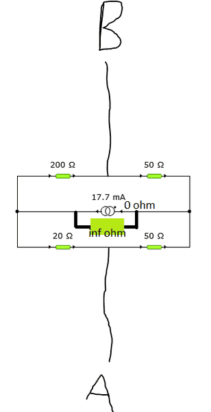

Okay, I almost understand. Am I correct if I say, no extra current (say if I connected a battery across A and B) can go through the current source because the current source is designed so that it maintains a constant current. So because no extra current can go through it, it appears as if it has infinite resistance?
  • Circuit schematic between points A and B with a 17.7 mA current source in the middle branch, a 0 ohm wire and a green box labeled inf ohm; resistors 200 ohm, 50 ohm, 20 ohm and 50 ohm sit in the outer branches.
Well, an ideal voltage source in parallel with an ideal current source is an invalid combination in network analysis. Indeed the current source is designed to provide a constant current. If any load is connected to a current source and all the current passes through the load, then there is no "leakage" current and hence, internal (parallel) resistance of an ideal CS is infinite.

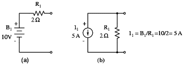

This is a diagram showing source transformation with 'practical' sources.
Two circuit diagrams labelled (a) and (b): (a) a 10V battery B1 in series with a 2 Ω resistor R1; (b) a 5 A current source I1 in parallel with a 2 Ω resistor R1, with I1 = B1/R1 = 10/2 = 5 A.
Practical current source with parallel resistance is equivalent to practical voltage source with a series(intetnal) resistance. Note that both the resistances are same. In CS, it appears in parallel(current division takes place) while is VS, it is in series(voltage division takes place). If you use load resistance as 2Ω, you can see, in VS diagram, voltage across load is 5V. It is same as in the CS diagram, where current through the load is 2.5A.
