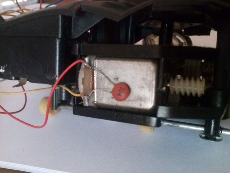

what is the function of the cap 104, why is it there? what's the function of this cap in the dynamo.. i know caps are used in motors for P.F correction, but what about the dynamos in toys??
  • Close-up of a small DC motor inside a toy, with a red disc ceramic capacitor marked 104 soldered across its terminals and red and yellow leads attached.
probably to 'absorb'(or suppress) the electrical noise from sparking at the motor's brushes.
Observe it's been placed as close to the noise source as physically possible which is good practice.

That looks more like a DC motor than a dynamo. The worm gear confirms it.
The 104 capacitor is 10 0000 pF = 100nF and is there to prevent radiation of RF noise from the sparking at the brushes.

I once used a small motor like the one pictured and controlled it with a 555 IC. Need for bypass capacitor at motor was immediately obvious.
