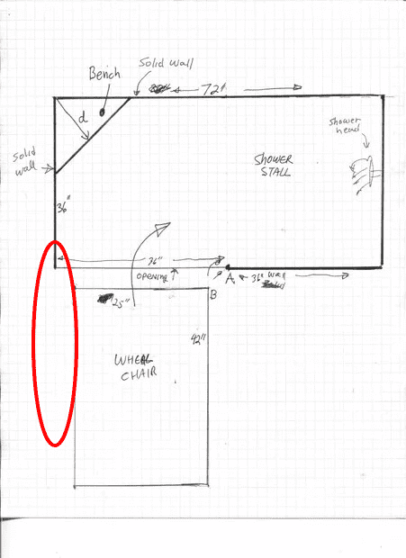

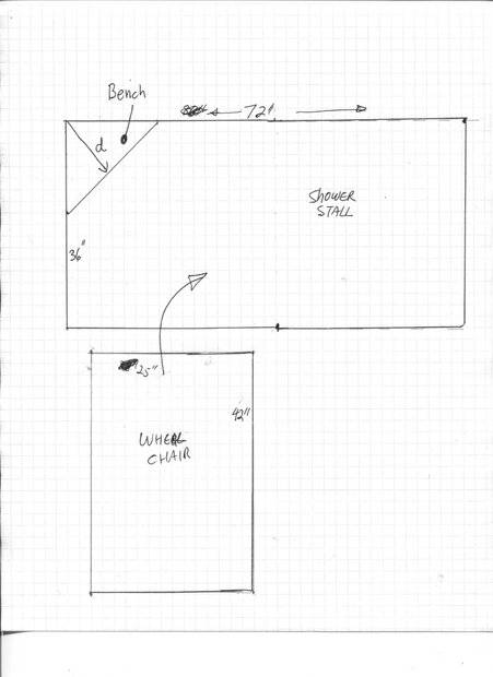

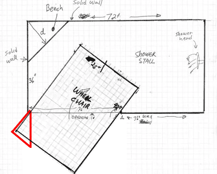

Homework Statement:: I have a shower and wheelchair as shown in the attached figure. The question is, how deep can the bench be made and still allow the wheelchair to enter the shower.
Relevant Equations:: x^2 + y^2 = r^2 ?
I need to know the maximum depth, d , of the bench that will allow the wheelchair to fully enter the shower stall.
Obviously, the chair can twist in any way as it enters. If the bench is too deep, the chair will not enter.
I know the problem, I do not know the solution. Help.

There is a measurement missing from your diagram: the location and width of the entranceway to the shower.

What constraints do you think you will run into getting the wheelchair in?
What will that do to the path of the wheelchair?
Can you quantify the constraints?
It might help you to start solving this if you sketch it.

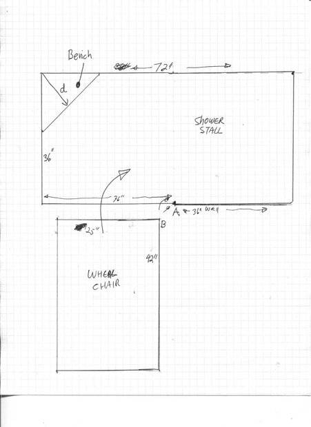

Here is a better diagram. If I assume that I start with point A and B together and then swing the chair around, it will not go through the door. So, the chair must be put partially into the door, and rotated, some amount to get it through. I am unsure how to calculate this. I think this is an interesting problem in that how do furniture makers insure they can get their large refirgerators into a kitchen through many doors.

Please add the placement and sizes of the front and back wheels for the wheelchair. Those are important. And have you thought about how the answer may be different whether the person rolls the wheelchair into the shower forwards or backwards? :wink:
Update -- and please show the wall to the left of the shower. Is it flush with the entry, or is there room to swing the wheelchair some in that direction to angle into the shower?

And the wheelchair is not a box with those outside dimensions. It is a 3-D shape that can fit under/over stuff. For example, the footrests stick out in front, and can easily pass under the bench as long as the bench supports do not go all the way to the base of the shower (which they don't usually). You should try to do a more complete 3-D analysis.
BTW -- fitting the footrests under the bench when going into the shower may be a big help, and lead more toward going in front-first instead of backing in. Are the shower head and shower controls on the left or right of your drawing?
And you didn't comment yet about where the left wall is in your figure.

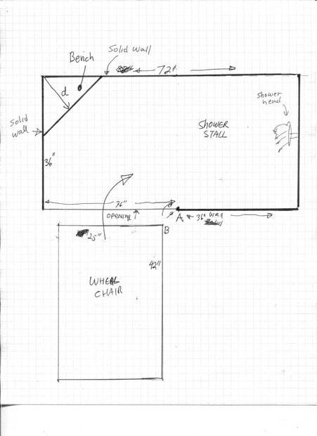

I have edit my diagram showing the solid wall.
I realize that I could do a cut out but isn't there a mathematical way to do this more precisely?
Also, I know that foot rests can be moved a bit but I look at this as a general math problem whether it is about a wheelchair or not. If I assume a piece of 25 X 42 plywood how would I find the distgance d?

There are two critical constraints during the 90°, two-step turn.
Consider the first part of the entry progress. As the 25” chair passes through the 36” door, it may turn through a maximum angle before it becomes too wide for the door;
Acos( 25" / 36" ) = 46°;
So the chair front can avoid any 45° internal shelf during the initial entry. That assumes the approach is not blocked by any external wall on the left.
The second part is another turn. The length of the front of a maximum shelf is;
36" * √2 = 50.9”;
The chair has a length of 42”, which is less than the available 50.9”, so there should be no problem.

But wait. I want to have a bench in the corner. How big can I make the bench before it prevents the chair from entering. The bench would take away from the 50.9 inches I think. Don't forget that the chair can be pushed into the opening as it is being turned. Does this make a difference? Hmmmmmm...

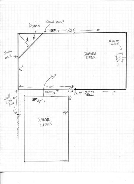

Yes, I forgot to mention this. I will correct my diagram

You are thinking about a difficult solution, I am showing that it is not necessary to analyse it to full depth.

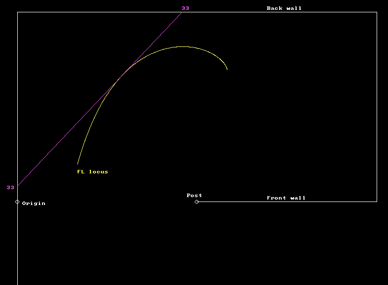

There are two critical points during the process.
1. You enter the space by running at 45°, parallel with the front of the maximum sized bench.
2. Then, when completely in the space, you turn the remaining 45°.
barryj said:
I thought this could be solved mathematically...
It can with an ideal wheelchair. In particular, the location of the wheels would have to be on the very corners of the device and be of zero size. But that will have no bearing on any real scenario.

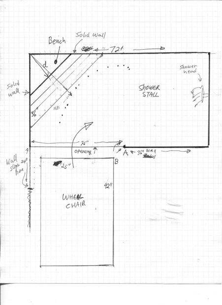

There is a wall I forgot to mention. It extends 24 inches. I see that this will affect the angle at which the chair can be rotated upon starting to enter the area.
Now, my previous analysis is invalid, because you have moved the goal posts and invalidated the specified external wall assumption.
Me, I would approach your problem from a different angle*.
* see what I did there?
I would avoid compromising the space in which the scooter has to maneuver; instead I would look at a shelf design that is out of the way.

Given my latest diagram (I did not intentionally hide the "goal post", I just didn't consider it. I will try to put pt A on B, then rotate the chair, then shove it in as far as I can to try to see how large a bench I can have. Seems like this is becoming an interesting problem. I'll wonder the next time I buy a piece of furniture if it will fit through a door of my house given my house layout. Surely this problem has been solved many times.
