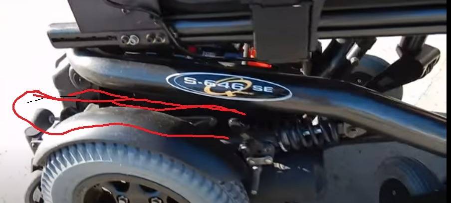

hi i have a 646 se from quickie powerwheel chair pride company.i bought it used
it always have had a pull on the right side as if the right side motor was weaker so to go strait i had to aim a bit at the left with the joystick.This summer the right motor or close to it started making a sound.recently i had the tire changed we took a brush from the right motor and it was close to the line quite used but still coupe mm to reach the line on it.
last week i opened the joystick and glued something ( i hope i did not mess anything up.)
today i asked the motor to go fast(i was in a hurry max speed) and it smelled smoke like burned varnish. i stopped the motor it was very hot.saw 2 smoke vaps go out. waited 10 minutes, from there on the chair was pulling a LOT on the right side almost not working. was it a protection device? Called a taxi to stop rolling with it while hotwhy did the motor heated up so much more than the left one( i was used to using it high speed befor and never had prob)What to do now? what does it look like?should i look to buy a new used motor or even used wheelchair change the brushes ? what to do thxcould it be bearing? Listen to the sound the right motor it makes video belowvideo with soundpicture of motor and chair
Safety First call for aid.
The two most likely are the brake not releasing or the motor has an internal short in a winding, with the brake being the most likely. Many motors of that type have the brake built into the motor. In either case, the motor is damaged to some extent, after all, some of the "Magic Smoke" escaped. :eek:

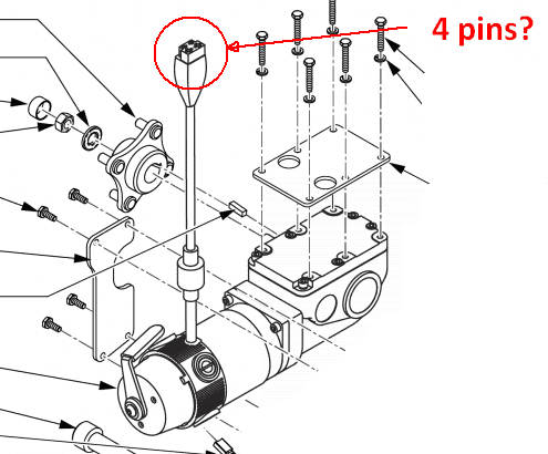

Quickie wheelchairs website is https://www.quickie-wheelchairs.com/ where, in the US, a new Quickie S-646 SE Rear Wheel Power Wheelchair is $8,495.
Full details on the motor including an exploded diagram can be found here where a new motor is less than $1,000. A new motor, if required, seems a worthwhile repair.
EDIT: The User Manual says there is a electromagnetic brake.
While the exploded diagram does not show a brake anywhere closer inspection of the motor shows there appear to be four pins on the plug suggesting the brake is internal in the motor(s).
The motor probably drives via a worm wheel on its shaft (it also provides the 90 degree change of direction needed).

tom G - hi. may be the smoke came from a non wire part. if i fix the heat issue will i still be able to use it ? what do you mean by will be broken?
-eng is my second language : what do you mean by the linkage from the brake release handle to the motor
do you mean the sort of round ball i pull do put the motor in neutral position (disengaged gear i imagine ) to allow someone to pull the chair for example?

Tom.G said:
Either the brake coil is in series with the motor so when current flows thru the motor it releases the brake, or there may be a separate wire from the Controller circuit board to release the brake.
See the youtube video links in post #6 where similar motors are disassembled and the brake removed.

ouichaise said:
since the lever with the ball was loose i tapped it so it stays in its possition.
after 10 min ride both motor has same temp approx.
So could it be that the slack in the ballarm to engage disengage the transmission could be the cause of all that?
Yes, it could be. But both the smoke and the smell indicate there is already damage somewhere. (Keep a hammer with you when you go out. :oldsmile:) How do the forward and reverse sounds compare to what they were.
It comes down to how much you want to risk a total failure when far from home, in bad weather, at night.
Only you can decide that. The safest way is to both find and fix the cause, and to repair any damage.

Hammer:
To keep the handle for the motor brake where it should be.

Hammer:
wow that sounds violent , il is loose i don't see how hitting it with force would help.
