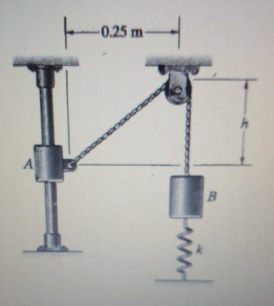

When i try to do this i end up with a fourth order polynomial

The collar A slides on the vertical smooth bar. Masses ma=20 kg, mb = 10 kg, and spring constant k = 250 kN/m. When h = 0.2m, the spring is unstretched. Determine the value of h when the system is at rest.
Diagram of a pulley system: collar A on a vertical smooth bar linked by a chain over a pulley to block B hanging on a spring k below; horizontal distance 0.25 m and vertical distance h marked.
sum of all forces equal zero
sum of all moments equal zero
f_g=mg
can some one please show me how to do this correctly?

I also get a 4th order polynomial in h. The equations are simple enough for the forces, but the clumsy geometry seems to create this complexity.
Ok, thank you I will try to solve it then.
