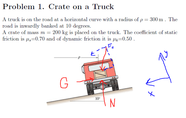

When the truck is at rest, will the crate also be at rest?

I have attached the known information.
When the truck is at rest, will the crate also be at rest or will it slide
downwards?
Sum F_y =0
G_max = (my_s)*N
G_min = (my_k) * N
I did a Free body diagram on the crate (see the attached file)
The first step is finding the normal force.
Sum F_y =m*a_y =0
N-mg*cos(10)=1932.19 N
now i find the friction forces
G_ max=(my_s)*N= 0.70*1932.19=1352.53 N
G_min=(my_k)*N=0.50*1932.19=966.10 N
Now i will find F_II
F_II = m*g*sin(10) = 340.70 N
since G_max > F_II there is no motion downwards i,e a_x = 0
I am not sure if I have done it correct.
Thank you for your help.
I assume you mean N=mg*cos(10)=1932.19 N
Yes.

Yes i ment N=mg*cos(10)=1932.19 N (isolating for N)
So I don't have to calculate for G_min? Meaning I can skip this part in the calculations?
Yes. You can assume the crate was placed statically. Until static friction is overcome, it is going nowhere.
I would have guessed there are more parts to the problem.

Okay. Thank you very much. And yes there are more parts to the problem, i am trying to solve them now.
