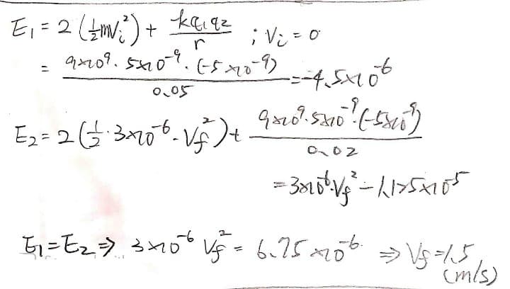

Two particles, each having a mass of 3.0 μg and having equal but opposite charges of magnitude 5.0 nC, are released simultaneously from rest when the two are 5.0 cm apart. What is the speed of either particle at the instant when the two are separated by 2.0 cm?
The answer is 1.5 m/s.
F = kQ^2/r^2
F= 9*10^9 (5*10^-9)^2 / (0.05)^2
a=F/m = F/(3*10^-6)
v^2 = u^2 + 2aS = 0 + 2a*0.03
v = 60
Where did I do wrong? Thanks!

I'm thinking about using this equation: U = 1/2mv^2 + kQq/r
E1 = 1/2 * 3*10^-9 * 0^2 + 9*(-25)*10^-9/0.05^2
E1 = 1/2 * 3*10^-9 * V^2 + 9*(-25)*10^-9/0.02^2
V = 67 (m/s)
I cannot find a matching answer.

Looks like a tie, one error by you and one by the problem setter.
You have counted the PE of the system but the KE of only one particle.

Though this seems to be an electrodynamics problem, you have to use the two well known laws of classical mechanics: Conservation of energy and conservation of momentum. Be sure when you apply conservation of energy to correctly count for the potential and kinetic energy of both particles.
@hidemi to be constructive, here's what I would have expected you to do.
First, state that you have a system of two particles and that the total potential energy for such a system is: $$U = \frac{kq_1q_2}{r} = -\frac{kq^2}{r}$$ Where ##q = 5.0nC## in this particular case.
Second, you should at least have thought about whether this is the potential energy of the system or of each particle. And, you could have asked here for confirmation - that it is indeed the total PE of both particles combined.
Third, you should have identified the total KE of the system as: $$KE = \frac 1 2 mv_1^2 + \frac 1 2 mv_2^2$$
Fourth, you should argued (as above) that the particles must have the same speed - as they have the same mass and the same magnitude of Coulomb force acting on them.
That would allow you to rewrite the KE of the system as: $$KE = mv^2$$
Fifth, you use conservation of energy: $$mv^2 -\frac{kq^2}{r_1} = -\frac{kq^2}{r_0}$$ which gives you: $$v^2 = \frac{kq^2}{m}(\frac 1 {r_1} - \frac 1 {r_0})$$
Finally, you can plug the numbers into that.
This is what you should be training yourself to do. To think through a problem like this.

Thank you all for pointing out my mistakes! I finally got the correct answer 1.5m/s
But 1.5m/s is wrong. How did you get that? Should the 3μg be 3mg?
Yes, the 3μg is 3mg. And my calculation is as attached. Thanks!
