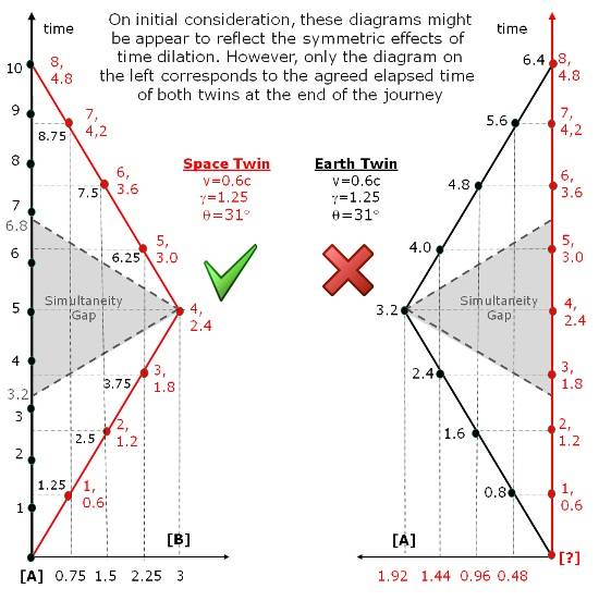

In the image below from the website http://www.mysearch.org.uk/website1/html/250.Twins.html , they try to explain why the two situations are not symmetric, but I don't understand their approach. Even if the website is not giving a sufficient explanation, I would still like to know why the two diagrams are not symmetric.
In the first diagram the space twin turns around, but the earth twin doesn't.
In the second diagram the earth twin turns around, but the space twin doesn't.

Then strictly by what you say, shouldn't that should be a symmetric situation? Why is the outcome different?

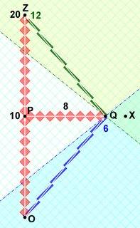

From my post at https://www.physicsforums.com/threa...y-affect-one-of-the-twins.989461/post-6346575
if you look at an asymmetric trip (different outgoing and incoming speeds),
  • you'll see that the non-inertial traveler's diagram
    will generally display the inertial worldline as a discontinuous worldline,
    as well as miss some events altogether (like the event P on the inertial segment)
    and show some events twice.
You can try to clean things up by using a smooth turn-around,
but the point is, with respect to the principle of relativity,
the non-inertial traveler is not equivalent to the inertial traveler...
since no such clean-up is needed for the inertial traveler.
To see how these "franksteined spacetime-diagrams" are constructed visit my answer at https://physics.stackexchange.com/a/507592/148184
The takeaway message is
"Being able-to-be-at-rest" ≠ "Being inertial".

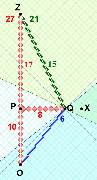

A non-zero acceleration anywhere along a worldline segment
will make that worldline segment non-inertial.
The clock-effect is the spacetime-path dependence of proper-time
along different worldline segments from event A to event B.
It is the analogue of the path-dependence of odometer length traveled
along different paths from point A to point B.
(The clock-effect is not necessarily about acceleration.... it's about path-lengths.)
The twin paradox is the mistaken claim of equivalence of a non-inertial traveler and an inertial traveler.
It fails to recognize that
(The twin paradox and the clock effect are related, but not the same thing.)

In Minkowski spacetime. a non-inertial traveler's diagram is not a complete map of spacetime.
As I said, its frankensteined spacetime-diagram omits some events and duplicates some other events.
That is... the worldlines might look correct, and may be correct in some cases,
but the rest of the diagram may have troubles described above....
so any attempt at equivalence fails.
In my opinion, the event-labels of each event (e.g. what the clock along the worldline reads at each worldline event) should be preserved between the diagrams... as I have done in my diagrams.
(I am not going to try to reproduce the analysis and intent of the original diagrams.)

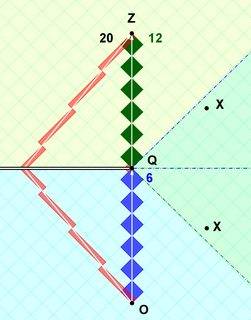

From the stackexchange link I posted, here is the symmetric case (for v=0.8c):
They are symmetric. The right hand one doesn't correspond to any meaningful analysis, obviously so because the clock ticks on the black worldline are wrong in the upper half.

Becasuse, as @Ibix said directly above, the second scenario posits an assumption (the Earthbound character turns around, i.e. accelerates) that has no basis in reality and thus is a bogus analysis of anything meaningful.
Said, another way, the diagrams are symmetrical on paper, but that fact is meaningless because the second diagram is meaningless.

Nothing breaks the symmetry. Were we not clear? They ARE symmetrical, it's just that one represents reality and one does not.

I would like to know why one does not represent reality. Why does the scenario on the right turn into the image that robphy posted (since the image in the OP is not really correct) on the right side of the screen in post #4. Why aren't they symmetrical diagrams? Is it only because of non-inertial frame/acceleration, or are there other reasons?
As you have been told repeatedly, YES.
View attachment 320710 View attachment 320709

Because the diagram on the right is not a diagram of an inertial frame. In fact it's not even a diagram of a non-inertial frame. It's just something the website author waved their hands and drew to look like a mirror image of the diagram on the left, without even asking the question whether that mirror image diagram represents any actual valid coordinate chart. It doesn't.
