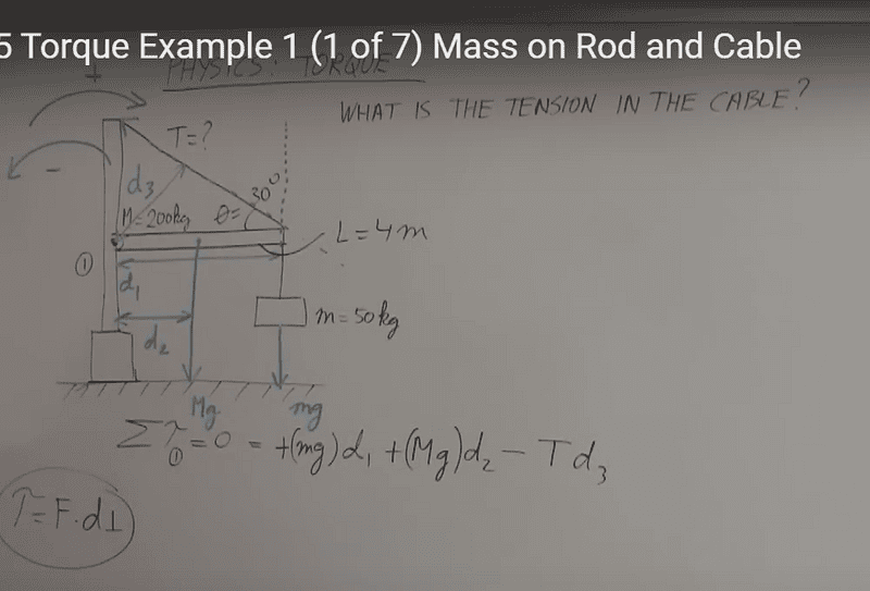

Why are these forces not included in the solution? (Torque Problem)
The discussion revolves around a torque problem involving forces acting on a beam with a mass hanging from it. Participants are questioning why certain forces, such as tension in a string and normal force from a rod, are not included in the torque equations presented in instructional videos.

So please find both screenshots below taken from these youtube videos:
Why in the first problem, the tension in the string, from which a mass hangs, is not included when the teacher is placing all torques in the equation (see image)?

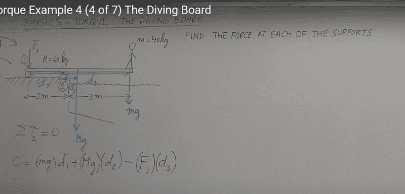

Why in the second problem, the normal force from the rod on the man, is not included when the teacher is placing all the torques in the equation (see image)?

You have to decide what system you are considering. If you consider only the beam then the box/man is not part of the system and you have a tensile/normal force acting as an external force on the system. If your system is the beam + box/man, then the tensile/normal forces are internal amd not part of the force/torque balace. Instead you have the gravitational force on the box/man as an external force on the system.
Thank you for your reply, it makes sense. While I was checking answers, I ran across this video: .
If you have time to check it, in particular from minute 2:23 till 2:51. I failed to understand what he meant by saying that it is NOT the weight of the person, but he is going to put it there anyway. I found similar videos to his, trying to point out the same idea. What do you think?

The weight of the person is defined as the force with which the Earth attracts the person.
The force that was drawn in the free body diagram is the force that the person exerts on the board. They are NOT the same force.
You can see the difference between the two by looking at the their reaction counterparts. The Earth attracts the person with force ##m_pg## down and the person attracts the Earth with force ##m_pg## up. The person exerts a force ##N_p## down on the plank and the plank exerts a force ##N_p## up on the person. Just because ##m_pg## is equal to ##N_p## here, you cannot conclude that they are the same force. If Jimmy is 23 years old and Bobby is also 23 years old, this doesn't mean that Jimmy and Bobby are the same person.

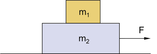

Example
Mass ##m_1## is on top of mass ##m_2##. The bottom mass is pulled along a frictionless surface with constant force ##F## and the to masses accelerate as one. Given quantities are ##m_1##, ##m_2## and ##F##.
Find the force of static friction on the top mass.
Analysis
If you draw a force diagram choosing as system the top mass, you will realize that the only external force in the horizontal direction is the unknown force of static friction ##f_s##. You can apply Newon's second law to get $$f_s=m_1~a\tag{1}$$which does not answer the question because you don't know the acceleration ##a##.
So you choose a second system consisting of the two masses together. Here, the only external horizontal force is ##F## and $$F=(m_1+m_2)a. \tag{2}$$Now from equation (2) you can get an expression for the acceleration ##a## in terms of the given quantities, put that in equation (1) and you have the answer.
(This is an illustration of what @jbriggs444 is talking about and posted before I did.)
The explanation is at minute 1:30.
He is referring to the weight of the person in the same way he previously referred to the weight of the board: as forces not touching each body directly.
The feet of the diver exert one of the several forces directly touching the board and inducing torques.
In this statically balanced situation, the magnitude of that vertical force exerted by the feet on the board happens to be exactly as much as the force induced remotely by gravity in the center of mass of the diver.

He is skipping s bit and being sloppy. If you want to be painfully thorough you first do the force equilibrium for the load, which tells you that the weight of the load is equal in magnitude and opposite in direction to the normal force from the beam on the load. By Newton’s third load, the weight is therefore equal to the normal force from the load on the beam. This is sloppily referred to as the weight of the load acting on the beam.

Typically, what is considered is the system of the beam only. As I said earlier, which forces are considered depends on what system you consider. If you consider beam+load, the weight is an external force on that system because it acts on the load, which is part of the system. In that case there is no ambiguity in saying that the weight acts on the system.
