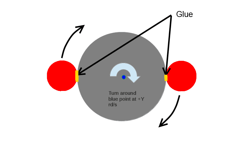

With friction ON the red disks are effectively glued to the grey disk. You can calculate the energy stored in the system if you calculate the moment of inertia for the combination.
Diagram of a grey disk rotating about a blue point at its centre, with two red disks glued to its left and right edges by yellow tabs. Curved arrows show the red disks moving outward, and the label reads "Turn around blue point at +Y rd/s".
Energy = 0.5 (I1+I2) w2

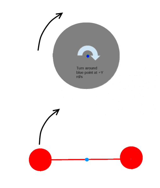

With friction OFF you have two separate parts. You can calculate moment of inertia for each and the energy stored in each.
Diagram of a grey disk with a curved arrow and the label 'Turn around blue point at +Y rd/s', above two red disks joined by a red bar with a blue point at its centre, also with a curved arrow.
Energy = 0.5 I1 w2 + 0.5 12 w2
You get the same answer because moments of inertia add up (if they are on the same axis) and the angular velocity (w) is the same.
