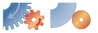

Ibix said:
That's the point I was trying to make in #30. The Lego gears is a good demo idea.

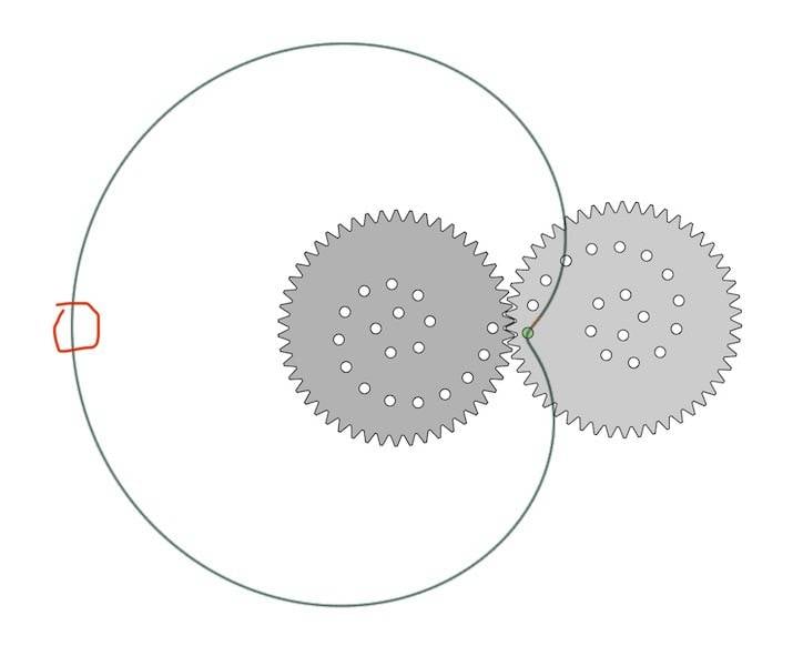

But that was my argument. The lego/spirograph gear shows that the outer ring (in the 1:1 size scenario) only went around the inner circle once.
source: https://nathanfriend.io/inspiral-web/

  • #46
When the “spirograph pen” reaches the point circled in red, the moving gear has completed 1 full rotation, and is only half way around the other gear…
  • #47
Yes, I'm quite aware of that fact.

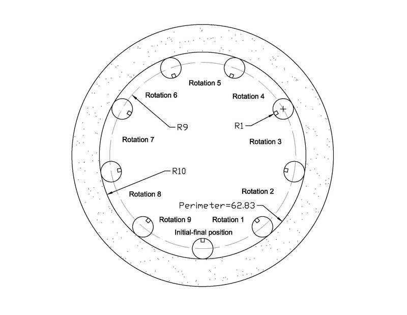

Yes, the image below that @Devin-M posted tracks the wrong point. To directly get the right quantitative answer, it should track the center of the large circle. But the general idea, that the circle rotates more, because it is travelling further, is on the right track.

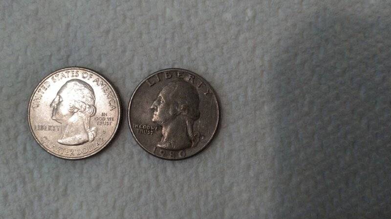

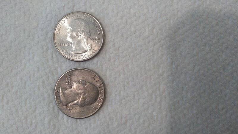

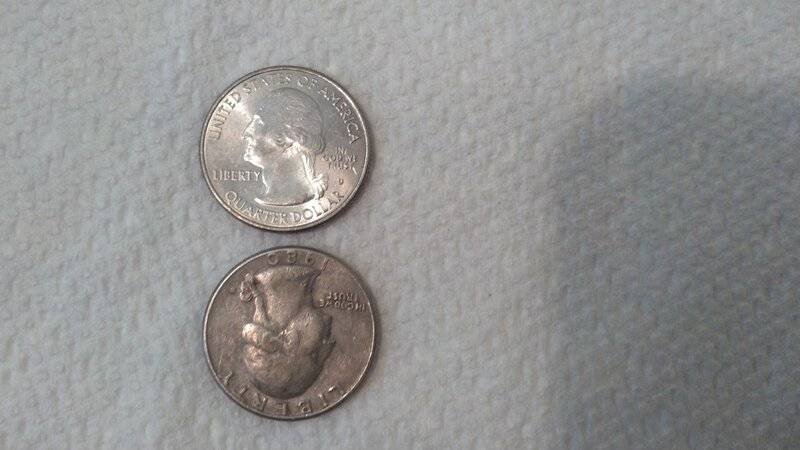

-Suppose we have a radius 1 coin and a radius 10 coin.

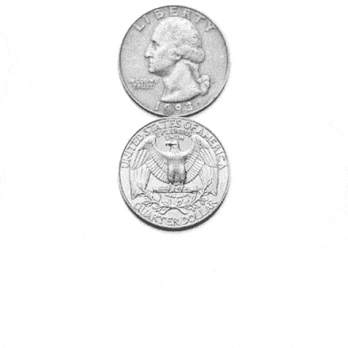

  • #58
We start with the above.
Rolling it around so the dull coin is on the bottom gives us an inverted dull coin relative to the first pic.
This last image is of course wrong. The part of the coin with Washington's nose would have to continually contact the shiny coin on its trip around. This action is not rolling.
When intuition gets you in trouble as it often does, work out a path to the answer by showing how it cannot work as your intuition says it would.
