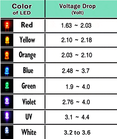

Hi,
im doing a piezoelectric energy harvesting project with a standard harvestings circuit consisting of a full bridge rectifier, smoothing capacitor and a resistive load. I managed to get around 28V after rectification without connecting to a smoothing capacitor and load, but when i added a LED parallel to the smoothing capacitor, my voltage instantly falls to around 2.4V and remains the same. Can someone tell me why will my supply voltage from the piezoelectric dropped so much when a LED load is added?
any kind of help would be really appreciated! thanks
You should be thinking about power, not voltage. My guess is that the piezo system is having difficulty supplying enough power for the LED.
You have done well to get that far. Does the LED light up?
thanks for replying! Yes the LED is able to light up with no problem, i can even add a few LED and all of them will light up. When i conduct the experiment, my piezoelectric is at its resonance. Thus, the supply should be quite consistent. As you mentioned for the power, how should i approach this problem?
Measure the voltage and use a variable resistor as the load. When the voltage falls to half the open circuit figure, the generator is giving its maximum power, and that is the optimum resistance for a load. Although a Piezo crystal is a capacitive source at low frequencies, if it is at resonance then it will be resistive.

Go with tech99's measurement. It should give you the internal resistance of the source. This is a useful value for moving beyond simple LED circuits. With it you can figure the output power.
If your goal is only to light LEDs, put them in series to the half voltage point. There could be a problem with too much current (at least theoretically) and LED's typically have a current limiting device to keep them from burning. Often this will be a resistor where losses aren't relevant, but more active choices are used when power is tight (hand held devices, etc.).

If you use LED as a load, it is not so easy; remember they do not obey Ohm's law, as described previously. You need to put LEDs in series to give the required load voltage. Why not use an incandescent lamp for test purposes?

Yes, correct. But when you use an LED or a battery instead of a resistor, it is an abnormal sort of load, and you will need to make its rated voltage suitable for the piezo generator. A milliammeter (or multimeter on mA range) placed in series with the load would be a useful way of monitoring the current being supplied. It is possible that when using LEDs, you will not require a series resistor, as the generator probably cannot supply enough current to cause damage.
