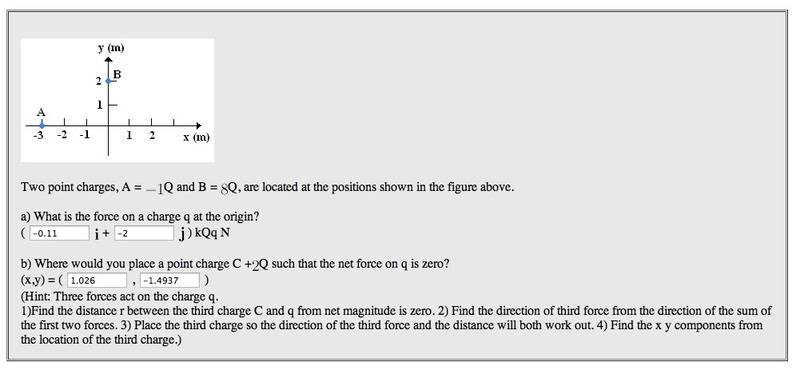

Pls help with number "B". The X component doesn't agree!
Ignore the data entered in the fields for X,Y(incorrect). I later figured Y component is "-1", but have no idea why X didn't work out.
Thx a lot!
Show your 1-2-3-4 steps as per the hint.
Yep; if you don't show us the reasoning we cannot help except to do the problem for you, and that would be against the rules.
