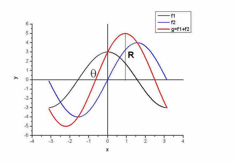

2.The linear combination of a sine and a cosine of the same angle always equals to a single sine or a cosine of an angle multiplied with a number. In Physics, it appears when two vibrations add up, or two waves interfere. The result is a new vibration or wave, with a new amplitude (it is R) and phase constant (it is theta).
In Maths, you have two functions f1(x)=acosx, f2(x)=bsinx . If you add them, you get the function g=f1+f2, which has the same shape - a sine or cosine function, but shifted and having a certain amplitude, different from a and b. See attachment.
ehild
ehild
Awesome explanation. Thanks.
