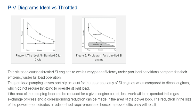

IF the engine is operating at wide-open throttle, then the cylinder pressure during the intake stroke, and during the exhaust stroke, are roughly at atmospheric pressure. Therefore the area inside the exhaust/intake loop (called the pumping loop) is roughly equal to zero. This means the engine is very efficient at wide-open throttle, which corresponds to full load.
But most of the time, a vehicle doesn't need all the torque an engine can produce. So we use the throttle to restrict the flow of air into the engine, and thereby reduce the work done per cycle (and thus, the torque). This reduces the positive work done during compression/expansion, reducing torque. But the pressure during the intake stroke is now below atmospheric, so there is a substantial amount of negative work in the pumping loop. The throttling process is thermodynamically irreversible, and represents a mechanical loss.
As the throttle is closed more and more, an increasing amount of the positive work from the cycle is used just to bring air in during the pumping loop. Therefore the efficiency of the engine steadily declines. At a certain throttle opening, the work done in compression/expansion is just equal to that of exhaust/intake, and the work output is zero. So is the efficiency.
So the main factor in efficiency dropping as load decreases is the throttle.

https://www.mechadyne-int.com/refer...ion/part-load-pumping-losses-in-an-si-engine/
As @Randy Beikmann said.

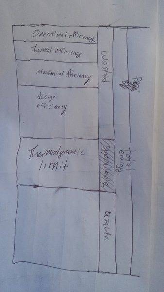

There is also operation efficiency, which is what this thread is about, and is not what you're talking about.

What you have not gotten yet is that an automotive engine which lacks a throttle drops in efficiency under light load also, which again, is what this thread is about. This is specifically operational efficiency and you are mixing thermodynamic and design efficiency in.
The efficiency stated in the OP is:

  • #55
That which effects the efficiency of the device but is outside the device and does not effect how the device is operated is a limitation factor, such as the efficiency drop that would occur the closer the temperature outside the device gets to the temperature inside the combustion chamber. This effects how the device is operating and not how it's operated. This is a thermodynamic limit, it is not thermodynamic efficiency.
Efficiency is the measure of an amount usable divided by total amount. Usable is the key word. Of the total amount, fuel in this case, some portion is used, some portion is wasted due to inefficiencies, and some portion is wasted due to thermodynamic limitation. That's why the term "thermodynamic efficiency" doesn't make sense when taking about engine efficiency. It's a limit and should not be combined with efficiency. When combined, which is too often, it is confusing and isn't meaningful.
That which effects the efficiency of the device and is from within the device is an efficiency factor, such as heat lost to the surfaces of the combustion chamber, which is a factor of thermal efficiency.
An automotive engine is a runaway device, and the most efficient way to regulate such a device is by loading it. This type of regulation falls in operational efficiency. As opposed to throttle regulating or fuel regulating, both of which fall under design efficiency.
Design efficiency is the most difficult category to deal with and is what largely determines the efficiency factor of mechanical and thermal efficiency. It is the base. Mechanical efficiency is next in line in terms of its effect on engine efficiency. And operational efficiency is separate from the engine, while still effecting engine efficiency because it effects the insides of the engine, how the engine is operated.
There are 4 categories of efficiency: design efficiency, mechanical efficiency, thermal efficiency, and operational efficiency. And now I have given some examples too, without having drawn a map yet. Who can populate the categories? How does what fit where?
It's not proper to haphazardly dip into different categories of efficiency and grab disparate concepts and mush them together and call it, for example, thermal efficiency or thermodynamic efficiency or whatever. There is a structure, and it's fixed. And efficiency must be understood under this structure. It is so confusing right now. Not in terms of mathematical formulations, but in terms of concepts of form/design.
I'll wait still before providing the map/picture of the categories and populating them. Just because thinking is good for us.

  • #60
Randy Beikmann said:
I don't necessarily agree with the way some quantities are defined in thermodynamics, but we need a common language in order to communicate outside this small group.
Something to start getting the idea across as I try to put more information together.
