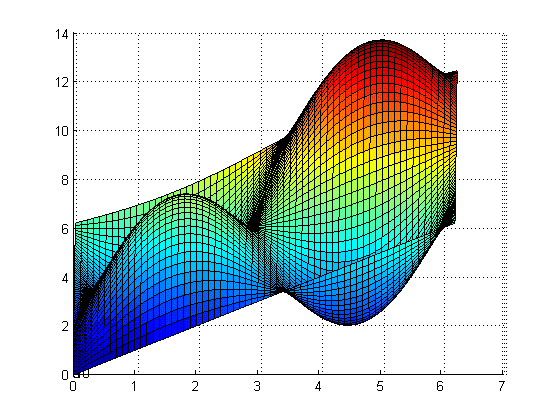

I have a function that is not giving me critical points for where their appears to be a maximum.
from plot their seems to be a cp at approximately x=y=5
However, these are the cp's:
cpx =
-0.2618
-1.3090
1.8326
2.8798
-2.8798
-1.8326
1.3090
0.2618cpy =
-0.2618
-1.3090
1.8326
2.8798
0.2618
1.3090
-1.8326
-2.8798
When evaluated on the boundry [0,2pi]x[0,2pi] F(0,0)=0 as a absolute minimum and F(2*pi, 2*pi)=12.5664 as absolute maximum...even though in the graph... 2*pi is lower then the imaginary big red mountain on right...for which their seems to be no cp...

So my question is...is their a cp at that red mountain? or is their no red mountain :P
They say when fx and fy DNE their is also cp...but i don't see that happening since fx and fy are polynomials...

Are you solving for fx = fy? Or better yet fx - fy = 0?
I kind of see that in your little problem, but everything after that seems like a blur.
Why don't you just solve the above expression, and check if those critical points are maximums?
I'm not sure if that is exactly what the graph looks like, so I'll assume you did it right. If you did it right, it seems like you do have a maximum. Now the problem is either the program can't solve it or the steps you're following are wrong.
Yea it looks like it's solving them equal to each other or considering both...same thing. It's how an example i found did it for these sorts of problems.
Mathematica gave same answers for critical points.
Solve[{0.0 == Fx[x, y], 0.0 == Fy[x, y]}, {x, y}]
{{y -> -2.87979, x -> 0.261799}, {
y -> -1.8326, x -> 1.309}, {y -> -1.309, x -> -1.309}, {y -> -0.261799,
x -> -0.261799}, {y -> 0.261799, x -> -2.87979}, {y ->
1.309, x -> -1.8326}, {y -> 1.8326, x -> 1.8326}, {
y -> 2.87979, x -> 2.87979}}
Hmm i think i got em...was reading some warning messages in mathematica that saying not all solutions may be found cause it was using inverse functions, and to use some function called Reduce...so with a bit of tinkering...
N[Reduce[{0 == Fx[x, y] , 0 == Fy[x, y], 0 ≤ x ≤ 2*\[Pi] , 0 ≤ y ≤ 2*\[Pi]}, {x, y}]]
finds these:
(x == 4.97419 && y == 4.97419) || (x == 6.02139 && y == 6.02139) || (x ==
1.8326 && y == 1.8326) || (
x == 2.87979 && y == 2.87979) || (x == 3.40339 && y == 0.261799) || (x == 4.45059 && y == 1.309) || (x == 0.261799 && y == 3.40339) || (x ==
1.309 && y == 4.45059)
and those look like the cp's i was looking for.
