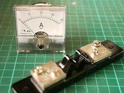

or cook the meter movement in the case on no fuse ... as many plain ammeters (panel meters) don't have
The pretty much only time a resistor is placed in parallel to the ammeter is when it is a shunt resistor and it will have a very small resistance value
compared to that of the meter movement winding
