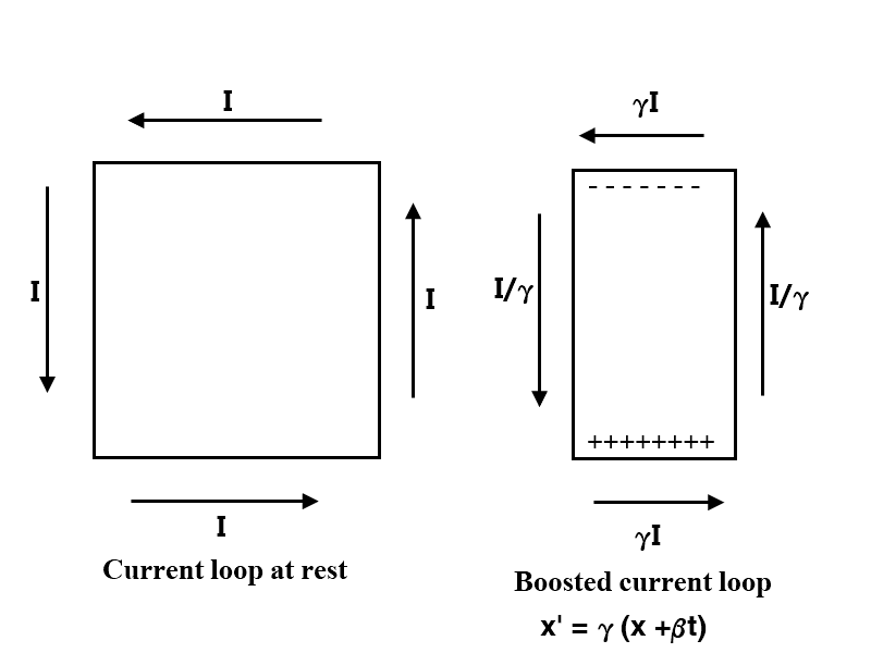

The following picture of what a moving (relativistic term: boosted) current loop looks like might be of help.
Two diagrams of a square current loop: at rest, all four sides labelled I with arrows circulating; boosted, the loop is contracted horizontally with sides labelled I/γ on the vertical wires and γI on the horizontal wires, plus dashed minus signs on top and plus signs on bottom, and the Lorentz transformation x' = γ(x + βt) below.
The +++ and --- are charges, so a local excesss of electrons would be represented by ----. On the sides of the loop without any + or - symbols, the wires are locally neutral.
Note that when you consider a complete current loop, charge is conserved - it's just redistributed. You don't create or destroy any charge, but because you've changed the definition of simultaneity, the locations of the charges are no longer evenly distributed along the wire.
I'm not sure where you are with the math, the number-flux 4 vector or equivalently the charge density / current four-vector give you the mathematical tools you need to really analyze the problem - that's what I used to generate the diagram.
