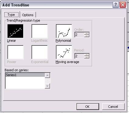

I have a graph of values, and I am trying to add an exponential trendline, but it won't allow me. Can anybody help?
So what happens when you try to add the trendline?
I assume you are clicking on the ploted data series then selecting the chart menu and then add trendline
It shows a blank box where the exponential picture is, and the word "exponential" is grayed out.
EDIT:
Excel Add Trendline dialog, Type tab: Linear is selected, while Logarithmic, Power and Exponential are greyed out and Polynomial and Moving average are available; Based on series lists Series1.
That feature may not be installed or enabled yet. Look for Tools, Add-Ins, or something like that. Some of the more specialized tools are not installed with the default installer, but can be added in later as needed.
Plasma said:
After Add-ins, it still doesn't work.
What does that mean? Was it listed as an add-in, and after adding it in, the feature is greyed or plain doesn't work? Or was it not listed as an available add-in?
There was no add-in for the graphs. I installed all add-ins just in case, but like I thought, nothing.

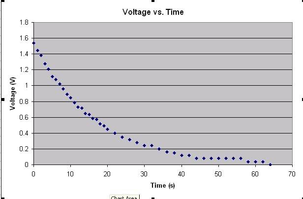

Just for kicks, did you try loading in the analysis toolpack add on? I have never seen a trendline option grey'd out like you are mentioning.
What does the data look like when it is plotted? What kind of plot are you trying to put the trendline in? I would first suggest you make sure that the plot is in an "xy scatter" and not a generic "line" format.

It is an XY Scatter that is basically made to exponential.

Your last data point seems to have Y = 0. For exponential data fitting all Y values have to be > 0 (because the maths involves taking logs of the Y values)
I tried a test with Excel, with and without a Y=0 point in the data set. If you remove the point you should get the exponential option in the menu.
Sure enough, if your chart has a zero value the exponential fit box is empty!
Good catch AlphaZero!
Yeah, I figured that out, but thanks anyway.
