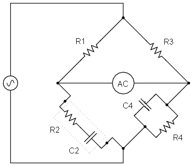

The ac bridge circuit shown is called a Wien bridge (also Wein bridge).
Show that when the bridge is balanced, frequency is found by the Eqn attached.
w=2*pi*f
Using the number from each branch as a guide, the general solution to AC bridges is Z4 = (Z3/Z1)*Z2
I keep trying to solve for impedences to plug into the second equation provided, but my j values do not cancel and the equation left is rather messy (R2R4C2C4*w^2 +jw(RzR4C2 -R2C2 -R4C4) +1 = 0.
For my impedence values I have been using
Z1 = R1
Z2 = R2 -j/wC2
Z3 = R3
Z4 = (R4/jwC4)/(R4 +jwC4)
Any help with this would be greatly appreciated.
I think Z_4 = \frac {-jR_4} {\omega C_4 (R_4 - \frac{j}{\omega C_4})}
Both the real and the imaginary parts of Z4 = (Z3/Z1)*Z2 must be 0
Actually, I think our Z4 values are the same, since -j = 1/j. But thank you! I managed to figure it out after you got me thinking about real and imaginary parts.
It's fairly simple, actually: I just had to equate the real parts from my equation so that R2R4C2C4*w^2 + 1 = 0 (and then I took absolute value).
