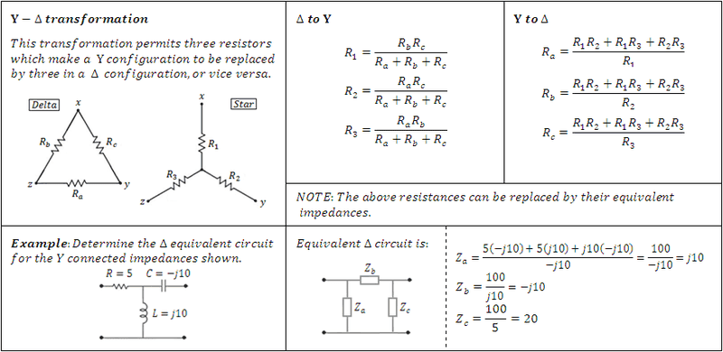

Y-Delta transformations
Reference sheet on Y-Delta transformation: Delta and Star resistor configurations with formulas for R1, R2, R3 and Ra, Rb, Rc, plus a worked example converting a Y network with R=5, C=-j10, L=j10 to a Delta equivalent with Za=j10, Zb=-j10, Zc=20.

What I did: I transformed the three impedances in their delta config to a Y config, and my TI89 told me that the only impedance in the Y config that caused a phase shift (by virtue of the entire impedance value being imaginary), was that single impedance connecting down to common ground from in between the other two.
The calcs wound up as
[tex]Z_1 = \frac{CL_1L_2\omega^3j}{C(L_1+L_2)\omega^2-1}[/tex]
[tex]Z_2 = \frac{CL_2L_1^2\omega^4}{(C(L_1+L_2)\omega^2-1)^2}[/tex]
[tex]Z_3 = \frac{CL_2^2L_1\omega^4}{(C(L_1+L_2)\omega^2-1)^2}[/tex]
Z1 being the one that connects to ground from in between 2 and 3 which are in the op-amp loop.
Making Z1 go to infinity by making it's denominator go to zero when the frequency is the fundamental frequency, gets us the equation we need to prove.
I'm fine with the mathematical reasoning.
I just don't feel comfortable with the idea that this theoretically infinite impedance is causing no phase shift? Why does current have to flow through a component in order to be phase shifted?
