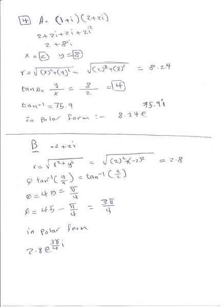

Hi
I want check my answer
4 - write answer in both rectangular from and polar Q in degre
a ) (1 + i ) ( 2+ 2i )
b ) -2 + 2i
In part (a), you seem to have assumed that (2i)2=4i, which is wrong...(2i)2=-4.
In part (b) you have written: tan-1(2/2), where it should be: tan-1(2/-2). Also I don't understand why you have written: 45-\pi/4.
