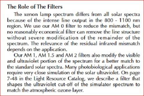

See if this resource is of any help in familiarizing yourself with the terminology.
http://assets.newport.com/webDocuments-EN/images/12298.pdf
a snippet from page 10 of 32
