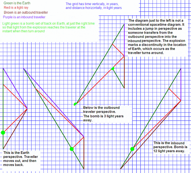

I have considered a concrete case where a traveller moves 6 light years at 60% the speed of light, turns around effectively instantaneously, and then returns at the same speed; all these values being as determined by a twin at rest at the starting point. The description, including some spacetime diagrams, is at msg #46 of Twin Paradox- a quick(ish) question.
Here's a diagram, showing what goes on in three different inertial frames; the twin who is inertial the whole time, the traveler on the outbound leg, and the traveler on the return leg.
The discontinuity shows up at the moment of turn around, it corresponds to the turning twin changing from one frame to another. In the new frame, the light that they are receiving from the start point is coming from four times further away than it was in the old frame.
This would be confirmed by any measurement made by the traveling. In particular, the angular size in the sky of the planet where the stay at home twin is waiting will reduce by a factor of four as the traveling twin turns around; the angular size is an indicator of how far away the object was when it emitted the light that you are "seeing" at the moment.
Cheers -- sylas
Cheers -- sylas

As I was trying to show in the diagram, it is the turn point which involves a "leap" in Earth time, and this is because of a change in frame, whether that change in frame is due to an acceleration or due to some other mechanism we might propose with no acceleration or gravity involved.
Buckethead said:
I'm going to stay logical here and assume that there is no "real" sudden jump in simultaneity and that a sudden fast forward in Earth time from the ship is not something the ship would see.
"Logic" in these discussions is nearly always an example of someone holding onto an invalid assumption that is actually incorrect.
In this case, it's a bit subtle. What the ship "sees", of course, is light that left Earth a long time ago. How long ago depends only on how far away the Earth was at the time the light was emitted.
That DOES change instantaneously, at the turning point, and the turning ship DOES see it. What they see is that the home planet is suddenly (instantaneously) much much further away. Specifically, in the case where an observer moving at 60% light speed suddenly reverses (whether by acceleration or time warps or teleporting into another passing ship) to be 60% light speed in the other direction sees the remote planet suddenly four times further away. It's a real observation. The remote planet really will be four times smaller in the sky. The brightness will be affected by doppler shifts as well, but taking that into account still gives the same result... the remote planet is suddenly seen to be four times further away.
This is seeing via the light that left the remote planet 3 years ago (in the first frame) or 12 years ago (in the second frame).

I think sylas was talking about optical appearance which take into account light delays, not what is true "instantaneously" in the inertial frames where the accelerating object is at rest immediately before and immediately after acceleration. For example, suppose I am traveling away from the Earth at 0.6c, and then when I am 12 light years from Earth in the Earth's frame, when the Earth's clock reads a time of t=100 years, I instantaneously accelerate so I am traveling towards the Earth at 0.6c. Since in the Earth's frame I was 12 light-years away from the Earth both immediately before and immediately after acceleration, visually I will be seeing the Earth as it was when the Earth's clock read t=88 years. And if I have an inertial ruler at rest relative to myself before the turnaround, such that before the turnaround I am at the x=0 l.y. mark on the ruler, then when the Earth's clock read t=88 years it must have been passing the x=6 l.y. mark on this ruler.* But if there is a second inertial ruler which is moving in such a way that I come at rest relative to it after the turnaround, again at the x=0 l.y. mark on this ruler, then when the Earth's clock read t=88 years it must have been passing the x=24 l.y. mark on this second ruler.** So, immediately before the turnaround I will see the Earth as 6 light-years away on a ruler at rest relative to myself, but immediately after the turnaround I will see the Earth as 24 light-years away on a ruler at rest relative to myself, so the visual distance has seemed to increase by a factor of four.
*This ruler is moving away from the Earth at 0.6c, so if the x=0 l.y. mark on this ruler is 12 l.y. away from the Earth at the moment I turn around (which in the Earth's frame is simultaneous with the Earth's clock reading t=100 years), then the x=0 l.y. mark must have been passing the Earth 12/0.6=20 years earlier in the Earth's frame, when the Earth's clock read t=80 y. In the ruler's frame the Earth's clock is running slow by a factor of 0.8, so a time of (88-80)/0.8 = 10 years must have passed in this frame between the x=0 l.y. mark passing the Earth and the Earth's clock reading t=88 y, so since the Earth is moving at 0.6c in the ruler's frame the Earth must have been at position x=6 l.y. on the ruler when its clock read t=88 years.
**This ruler is moving towards the Earth, so the x=0 l.y. mark on this ruler will finally reach Earth after a time of 12/0.6=20 years in the Earth's frame, when the Earth's clock reads t=120 y; and in the ruler's frame the Earth's clock is running slow by a factor of 0.8, so the Earth's clock must have read t=88 years a time interval of (120 - 88)/0.8 = 40 years before reaching the x=0 l.y. mark, so since the Earth is moving at 0.6c in the ruler's frame it must have been at position x=40*0.6 = 24 light-years at the time it read t=88 years.

I am explaining here the consequence of standard results. See the conventional spacetime diagrams I already provided earlier in this thread, at msg #8.
It's much safer to apply Lorentz transformations, rather than attempt to do length contraction, as length contraction is not all that is involved here. If you try to use length contraction without full consideration of the problem you are very likely to get the wrong answer.
Consider again the case of travel at 60% light speed to a star 6 light years from Earth. For the twin remaining on Earth, they conclude that 10 years after launch, the ship will be arriving at the distant star. Hence, to send a radio message of congratulations, they need to send it 4 years after launch, so that after another 6 years the radio message will arrive at the star simultaneously with the traveler.
Now, using a simple case of Lorentz transformations with time and with one space dimension. You can do this with launch as the origin (0,0), but it works slightly easier using the arrival at the star of the message and ship as the origin. That is because we are speaking of the distances from this event in two different frames.
The "star frame" is the frame of the star six light years from Earth, which takes times 0 when the traveler and radio message arrives. Earth is at location -6 in this frame. The "outward frame" is the frame of a ship moving from Earth towards to the star at 0.6c (γ = 1.25) . Time 0 is when arriving at the star. The "inward frame" is the frame of a ship moving from the star back to Earth at -0.6c. Time 0 is when leaving the star.
The Lorentz transformations, simplified for units where c=1, are as follows:
<br /> (t&#039;,x&#039;) = \gamma ( t - xv, x - tv )​
Here are the events in three frames.
<br /> \begin{array}{l|l|rl|rl}<br /> \text{event (t,x)} &amp; \text{Star frame} &amp; \multicolumn{2}{l}{\text{Outward frame}} &amp; \multicolumn{2}{|l}{\text{Inward frame}} \\<br /> \hline<br /> \text{Launch from Earth} &amp; (-10,-6) &amp; 1.25(-10+3.6, -6+6) &amp; = (-8, 0) &amp; 1.25(-10-3.6, -6-6) &amp; = (-17, -15) \\<br /> \text{Send radio} &amp; (-6,-6) &amp; 1.25(-6+3.6, -6+3.6) &amp; = (-3, -3) &amp; 1.25(-6-3.6, -6-3.6) &amp; = (-12, -12) \\<br /> \text{Ship arrives at star} &amp;(0,0) &amp; (0, 0) &amp;&amp; (0,0) \\<br /> \text{Ship back at Earth} &amp; (10,-6) &amp; 1.25(10+3.6, -6-6) &amp; = (17, -15) &amp; 1.25(10-3.6, -6+6) &amp; = (8, 0) <br /> \end{array}​
Note in particular the event “send radio transmission”, transforms from (-3,-3) in the outward frame to (-12,-12) in the inward frame. That’s four times further away, also as shown in the spacetime diagrams.
This really is the correct answer.
Cheers – sylas
JesseM said:
...Mike was presumably not thinking about the optical question of what is seen at the turnaround, but rather the question of what events are actually simultaneous with the event of the turnaround in ...
Yes, quite likely; he can confirm himself if he likes what problem he was considering.
It's easy to get mixed up in these discussions. However, I do think I have been careful to describe precisely what I am quantifying. I don't mind explaining it again as required; all Mike said was that I needed to rethink, so I explained again the calculations, and -- as always -- described carefully what I was quantifying.
Cheers -- sylas
