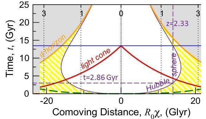

If I interpret this correctly, it means that the object has been outside our Hubble sphere up to around T=3 Gy, then entered the sphere and is leaving it now, to stay outside for as long as accelerated expansion keeps going.
Comparing the following table with the Davis center-panel expansion diagram, it seems that the column for R&#039;_{now} (the expansion rate history of a galaxy that is presently on our Hubble sphere) is valid.
{\scriptsize \begin{array}{|c|c|c|c|c|c|c|}\hline R_{now} (Gly) &amp; R_{∞} (Gly) &amp; S_{eq} &amp; H_{0} &amp; \Omega_\Lambda &amp; \Omega_m\\ \hline14&amp;16.5&amp;3280&amp;69.86&amp;0.72&amp;0.28\\ \hline \end{array}} {\scriptsize \begin{array}{|r|r|r|r|r|r|r|} \hline S=z+1&amp;a=1/S&amp;T (Gy)&amp;R (Gly)&amp;D (Gly)&amp;D_{then}(Gly)&amp;D_{hor}(Gly)&amp;D_{par}(Gly)&amp;R&#039;_{now}\\ \hline 3.336&amp;0.299760&amp;2.858302&amp;4.197327&amp;18.733&amp;5.616&amp;10.354&amp;8.375&amp;1.000\\ \hline 3.102&amp;0.322331&amp;3.178963&amp;4.643930&amp;17.702&amp;5.706&amp;10.801&amp;9.338&amp;0.972\\ \hline 2.869&amp;0.348578&amp;3.562786&amp;5.168812&amp;16.558&amp;5.772&amp;11.282&amp;10.497&amp;0.944\\ \hline 2.635&amp;0.379478&amp;4.027752&amp;5.789430&amp;15.280&amp;5.798&amp;11.797&amp;11.912&amp;0.918\\ \hline 2.402&amp;0.416389&amp;4.598945&amp;6.526791&amp;13.844&amp;5.764&amp;12.346&amp;13.669&amp;0.893\\ \hline 2.168&amp;0.461255&amp;5.311204&amp;7.404502&amp;12.220&amp;5.636&amp;12.927&amp;15.891&amp;0.872\\ \hline 1.934&amp;0.516956&amp;6.214226&amp;8.445751&amp;10.372&amp;5.362&amp;13.533&amp;18.766&amp;0.857\\ \hline 1.701&amp;0.587959&amp;7.379324&amp;9.665141&amp;8.260&amp;4.857&amp;14.151&amp;22.584&amp;0.852\\ \hline 1.467&amp;0.681570&amp;8.910486&amp;11.051952&amp;5.843&amp;3.982&amp;14.756&amp;27.828&amp;0.863\\ \hline 1.234&amp;0.810636&amp;10.959447&amp;12.543378&amp;3.088&amp;2.503&amp;15.317&amp;35.330&amp;0.905\\ \hline 1.000&amp;1.000000&amp;13.753303&amp;13.999929&amp;0.000&amp;0.000&amp;15.793&amp;46.686&amp;1.000\\ \hline \end{array}}
Here is a zoomed portion of the Davis center-panel:
The object presently on the surface of our Hubble sphere will be at redshift z~2.33. It was also on the Hubble sphere at t~2.86 Gyr (the dashed purple lines that I've added) when it first entered our Hubble sphere. Outside the Hubble sphere the recession rate exceed c.
Do you think this experimental column is useful? Or is it just cluttering up the calculator?

Beautiful graphic! I somehow missed this post yesterday. I am still unclear about the physical meaning of the righthand column quantity, and the example of the object we observe with S=3.336.
I'll keep thinking about it.
I see! You see the dashed line for T=2.86. On the right it does not extend far enough, it should go out to the light cone (where the object is).
But fortunately it does extend out on the left far enough, so it interesects light cone. It shows us that the current distance of the object is around 18.7 Gly just as your calculator says! The comoving distance to the object is around 18.7 Gly, which is pretty much where that T=2.86 line intersects lightcone.
And it also looks to me like the horizontal dashed line intersects lightcone around z=2.336 too, as it should. 2.336 would be say 2/3 of the way from 1 to 3, which it looks like it is. Also since the horizontal z scale is kind of "log-ish" and the "2" mark itself might not be exactly halfway between 1 and 3 but somewhat closer to the 3 mark, in case that matters.
So that all fits with what the top row of your latest table shows, for S=3.336
What is not so fortunate is that the Tamara Davis charts don't have an a(t) curve. The scale factor is used as a vertical scale up the righthand side, sort of as a alternative to time, to mark the stage in history. So we don't have an a(t) curve. Your new column is about the SLOPE of the a(t) curve.
I'm undecided about it, haven't figured out what I think. Somehow it should show a minimum around year 7 billion (you gave it exactly a while back, something like 7.6) Actually it seems to do that! I just looked at the S=1.7 row in the preceding table. That is year 7.4, close enough, and in fact it does look like da/dT is bottoming out right there. I'll get back to this after a while and try to give a coherent opinion :biggrin:

I have changed the 9th column header to be more sensible dot{a}R_0. This corresponds with the values shown on the zoomed center panel below. The redshift of an object that is on the Hubble sphere now is actually z~1.45 or S~2.45. I got that from my old Cosmocalc_2013, with Tamara's values. The z=2.1 represents a more distant galaxy, permanently outside the Hubble sphere, but whose photons managed to reach the Hubble sphere, and hence also to reach us.
Does this make sense?
Edit: Thanks Marcus, I have corrected the z=1.45.

It makes better sense with the new header!
You should probably check that the number S=2.67 is right. You might have intended, say, S=2.47, and simply misremembered. That's easy to do, memory glitch at one digit and the rest right. We should both check.
I will check using your parameters 14.0, 16.7, 3280. Let me see what I get when I put those in and look for an S that will give me the present distance D = 14.0.
I get S=2.454 using your numbers.
{\begin{array}{|c|c|c|c|c|c|c|}\hline R_{now} (Gly) &amp; R_{∞} (Gly) &amp; S_{eq} &amp; H_{0} &amp; \Omega_\Lambda &amp; \Omega_m\\ \hline14&amp;16.7&amp;3280&amp;69.86&amp;0.703&amp;0.297\\ \hline\end{array}} {\begin{array}{|r|r|r|r|r|r|r|} \hline S=z+1&amp;a=1/S&amp;T (Gy)&amp;R (Gly)&amp;D (Gly)&amp;D_{then}(Gly)&amp;D_{hor}(Gly)&amp;D_{par}(Gly)\\ \hline2.454&amp;0.407498&amp;4.338413&amp;6.201108&amp;13.998&amp;5.704&amp;12.202&amp;12.864\\ \hline\end{array}}
Using numbers that we were using earlier 14.0, 16.5, 3280 it's more like 2.43 (but about the same.)
{\begin{array}{|c|c|c|c|c|c|c|}\hline R_{now} (Gly) &amp; R_{∞} (Gly) &amp; S_{eq} &amp; H_{0} &amp; \Omega_\Lambda &amp; \Omega_m\\ \hline14&amp;16.5&amp;3280&amp;69.86&amp;0.72&amp;0.28\\ \hline\end{array}} {\begin{array}{|r|r|r|r|r|r|r|} \hline S=z+1&amp;a=1/S&amp;T (Gy)&amp;R (Gly)&amp;D (Gly)&amp;D_{then}(Gly)&amp;D_{hor}(Gly)&amp;D_{par}(Gly)\\ \hline2.430&amp;0.411523&amp;4.522759&amp;6.430132&amp;14.028&amp;5.773&amp;12.278&amp;13.434\\ \hline\end{array}}

I think I know now what the vertical dashed line labeled z=1.67 is supposed to be. With your numbers 14.0, 16.7, 3280, we get S=2.61 for the intersection of lightcone with Hubble radius.
That is, a galaxy we are observing today which was receding at c in the past when it emitted the light.
THAT is a galaxy which was subsequently inside the Hubble sphere, and then later was again outside.{\begin{array}{|c|c|c|c|c|c|c|}\hline R_{now} (Gly) &amp; R_{∞} (Gly) &amp; S_{eq} &amp; H_{0} &amp; \Omega_\Lambda &amp; \Omega_m\\ \hline14&amp;16.7&amp;3280&amp;69.86&amp;0.703&amp;0.297\\ \hline\end{array}} {\begin{array}{|r|r|r|r|r|r|r|} \hline S=z+1&amp;a=1/S&amp;T (Gy)&amp;R (Gly)&amp;D (Gly)&amp;D_{then}(Gly)&amp;D_{hor}(Gly)&amp;D_{par}(Gly)\\ \hline2.6104&amp;0.383083&amp;3.970&amp;5.7192&amp;14.929&amp;5.7192&amp;11.828&amp;11.737\\ \hline\end{array}}
So the vertical line for that galaxy does slice off a bit of the side bulge of the Hubble radius curve, just the way it appears in the figure. First it is outside Hubble sphere, then the sphere expands more rapidly than the galaxy is receding, and takes it in (for a while). Then its recession begins to dominate and it exits.
But that galaxy is not NOW at the Hubble radius. Your calculator says that its current distance is 14.929 Gly, not 14.0 Gly.
So instead of being labeled "z=1.67" the vertical dashed line probably wants to be labeled "z=1.61"
or S=2.61, and to be moved slightly over to the right so that it passes exactly thru the intersection of lightcone with Hubble radius. It will still slice off some of the bulge, on its way up, though slightly less of it.
OOPS! EDIT EDIT EDIT!
I see you relabeled that to say z=1.45. Now it makes sense, talking about a galaxy which is at comoving distance (now distance) Rnow = 14.0 Gly.
So multiplying that by the scale factor a(t) we get the past distance history of that galaxy
D(t) = Rnow a(t)
OK so that is a sample proper distance history. And you are going to take the slope of that.
And the slope should decline at first and then start increasing---the distance growth curve should have an inflection point where the slope is at a minimum. Which, as I recall, it does.
Yes! I checked on your table. S=1.636 is where the table minimum of the slope comes. Which is around year 7.6 billion. So that looks quite good. So I can see a real pedagogical benefit.
This is making a lot of sense now. I still don't have a definite opinion whether the 9th column pedagogical benefits outweigh the cost of having a more elaborate table. Probably it depends on who one expects to be the user.
So the vertical line for that galaxy does slice off a bit of the side bulge of the Hubble radius curve. First it is outside Hubble sphere, then the sphere expands more rapidly than the galaxy is receding, and takes it in (for a while). Then its recession begins to dominate and it exits.
I'll have to think about this a little more. A dotted vertical line represents a constant co-moving distance and, I think, a constant redshift over time. Galaxies below z ~ 1.67 must have entered the Hubble radius of the time and later exited it again. Now if the recession speed "then" must have been c when the galaxy entered the Hubble distance and again when it leaves it, there must be a single redshift that satisfies this condition for such galaxies. I could not find such a solution through the calculator, so now I'm a little confused. :confused:
What am I missing?

this is not a criticism of your Rnow a(t) column based on the vertical line labeled z = 1.45.
that made sense to me (and I edited my post) as soon as I saw you had relabeled it z = 1.45.
However there is a general comment to make. I think we need a notation for the maximum Dthen.
Dthen is the outline of the light cone, the galaxies we can be getting light from today. We've talked about its teardrop shape and its maximum girth, before.
If I call that maximum value of Dthen by the name "Dmax", Dmax = 5.7 or 5.8 depending on the parameters.
And the corresponding Smax = 2.61
And 2.61 x 5.7 = 14.9 billion light years, which is the comoving or now distance of a galaxy which emitted the light at the instant when it was receding at speed c, so that the light "stood still" at first, for a while and did not make any headway. this is a unique distance.
14.9 Gly is the unique comoving distance with that property.
There's a slight possibility of confusion associated with plotting Roda/dT in that it tracks the distance to something that is NOT ON THE LIGHTCONE.
Always in the past when we pick some S like S = 2.45 we are talking about a galaxy which we are getting light from today stretched by factor 2.45, and the distances in that row of the table tell us about the distance to that galaxy. So it's breaking with that precedent (for better or worse.)
You see the intersection of the horizontal line year 3.1 billion and the vertical S=2.45 is not on the red light cone curve. So we aren't getting any light from that galaxy that it emitted in years 3.1 and we aren't getting any light from it redshifted z=1.45. So the story with that galaxy is not LIKE the other stories we may be telling ourselves, habitually, about rows of the table. there is an "anomaly" in how we have to think about it.
But if you get back on the light cone, by using S=2.61, then your 9th column will be slightly different. The slope will start off at 1, at 2.61, and then it will decline as expansion slows, and then it will inflect and start increasing, and then it will reach 1 slightly BEFORE the present day, and then it will already be faster than light at the present. It will be greater than 1 at the present day. Which might not be a bad thing to show.
And you will be following the increasing distance of a real galaxy which we can see today, that is on our light cone. Because you start the vertical dash line at the INTERSECTION of the Hubble radius with the light cone.
I think that is pedagogically better, except that we have no NAME for SmaxDmax the comoving distance of the galaxy. Have to go, back later.
Back now. I guess one could fantasize teaching with this concept included in the kitbag. Explain that the past lightcone is onion-shape and the maximum proper radius we are going to call Dmax.
And then say that the COMOVING radius of the light cone (at its fattest) is going to be called Rcone. And we going to plot the recession speed history of a galaxy at Rcone.
this is a galaxy which, when it emitted the light we are getting, was RECEDING AT c!
So the speed number is going to be 1.
And that will be at S=2.61 and at a certain time, when it emitted the light, and when distance to it was increasing at c. So we picture that.
Smax x Dmax = 2.61 x 5.7 = Rcone = 14.9 Gly.
The thing which sent us photons that at first stood still is now 14.9 Gly from here, and we are getting the photons today.
And the 9th column record of Rconeda/dT starts at 1, when it emitted the light and was receding at c, and then it sags down because the thing's recession was slowing, and then it bottoms out and starts rising, and then it GETS TO ONE again, but it isn't the present yet. And by the time we come to present day it is actually receding a little bit faster than c. Good! That seems to work pedagogically.
However the cost is that one has to introduce a new concept Rcone the comoving radius of the past lightcone at its widest girth. So one has to weigh the cost. I'm interested enough I would like to see the 9th column used that way to get a sense of what it looks like.
I realize I haven't thought enough about this. The idea may have obvious flaws that I will only see later. But the 9th column (in units of the speed of light) does seem like an interesting idea. In future it would presumably show high multiples of the speed of light. And in past, before S=2.61.
