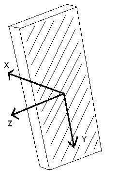

Hi,
I am trying to analyze a composite part which is made of carbon/epoxy and has [+45/-45]2s as the layup. I got the following material properties for carbon/epoxy from the textbook "Engineering Mechanics of Composite Materials", by I.M. Daniel & O. Ishai,
Longitudinal Modulus, E1=147Gpa
Transverse In-plane, E2=10.3Gpa
Transverse out of plane, E3=10.3Gpa
In plane shear modulus, G12=7Gpa
Out of plane shear modulus, G23=3.7Gpa
Out of plane shear modulus, G13=7Gpa
Major in-plane Poisson's ratio, niu12=0.27
Major in-plane Poisson's ratio, niu23=0.54
Major in-plane Poisson's ratio, niu13=0.27
The coordinate system of the part is shown in figure attached with the fiber laid up in the YZ plane. Can someone please tell me how I can transform the material properties given above into the coordinate system shown in (composite part.jpeg)
Thanks,
Barbara

Thanks for the reply. Here is what I did,
1. Calculate the compliance matrix using the available material properties.
2. Calculate transformation matrices for +45 and -45. This will be transformation about X-axis (i.e rotation about X-axis) since X-axis is the perpendicular out-of-plane axis.
3. Calculate ABD matrix using lamination theory
4. Calculate inverse of ABD matrix
5. Calculate material properties using the inverse of ABD matrix
The problem is that using this code, I get the out-of plane stiffness EX higher than the in-plane stiffness EY and EZ which I think is wrong since out-of-plane stiffness should always be lower.
Can you tell me whether the procedure I am using is right or not? I would really appreciate any help on this!

Im sorry there was a probelm in the last part of the code. Here is the correct one,

And here are the results,
EX = 1.470000000000000e+011 Pa
Ey = 1.112375948628138e+010 Pa
EZ = 1.112375948628138e+010 Pa
niuxy = 0.27000000000000
niuyz = 0.50321074138938
niuxz = 0.27000000000000
Gxy = 7.000000000000000e+009 Pa
Gyz = 7.000000000000000e+009 Pa
Gxz = 3.344155844155844e+009 Pa
