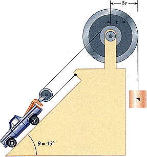

Find the mass m of the counterweight needed to balance the 1600 kg truck on the incline. Assume all pulleys are frictionless and massless.
Picture attached
Conditions for static equilibrium so that angular acceleration=0:
\sumTorque=0
We're learning about rotational dynamics and torque and I honestly cannot make the connection between that and this problem. Please help ):

Welcome to PF!
Hi xdevinx! Welcome to PF! :smile:
I can't see the diagram yet, but if this is a standard weight-pulley-weight problem, then rotational dynamics and torque and irrelevant …
just call the tension T, and use good ol' Newtons second law twice (once on each weight). :wink:
