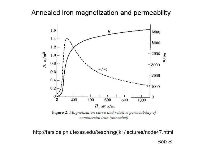

  • #51
Hi trini-
The iron powder dominates the field properties inside the coil, and Blongitudinal is continuous, so the iron powder will determine the B field in the sample. Do you have a curve like my annealed-iron thumbnail for the powder?
Bob S

  • #52
i have a similar graph but not one including the relative permeability, though i can say it is effectively 939,014 at my density. I think it is safe to assume that a 15A current will more than drive the powder material to this permeability in this core. My scanner is down so i can't upload the graph, but is it agreed that this is the best way to go for my project?
EDIT:
totally missed the point of your question, no i don't have one of those graphs for the iron powder i'll be using, i still have to locate it.
  • #53
trini-
Nothing has a permeability that high. Mu-metal is like 50,000. I suspect that you should use a number more like 700. Your formula for H should look something like my formula from Smythe, and you should specifically be correcting for the width of the coil if it is more than say 25% of the length of the coil.
Bob S

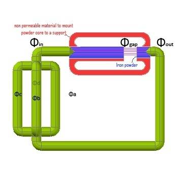

I updated my design module, making this a more typical magnetic circuit:

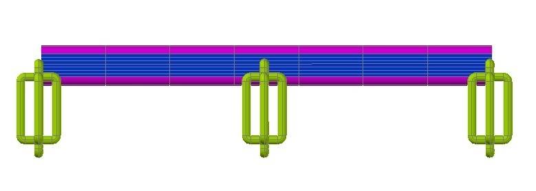

  • #59
Ok so I've been meddling around with my magnetic circuit design, and right now my biggest problem is having enough ampere turns in the space. in my current design(see above attachment), i can fit 6 turns of gauge 0 amp wires per side.this still requires a huge current to fully utilise the size of wire. instead, i have devised a plan to maximise space and minimise required current.
I will construct a series of magnetic flux 'cells'(shown below) which can then be any required length to allow for any desirable amount of turns. the cells will be made out of annealed iron rods, and will 'impale' themselves into the powder core, which I can make into any shape I desire. Each cell will consist of 4 parallel magnetic flux sources, so the total flux into the powder core would be 4 times each of the sources' flux. I will distribute these cells evenly throughout the length of the powder core to ensure uniform field distribution.
I would be foolish to assume there would be uniform permeability throughout the powder core, so my main goal should just be to drive the core to saturation( about 1.2 T). My magnetic material has an Msat of 0.925 T, so I think all I have to do is create a field of that or higher in my air gap to saturate my material, unless Msat means something else entirely.

  • #60

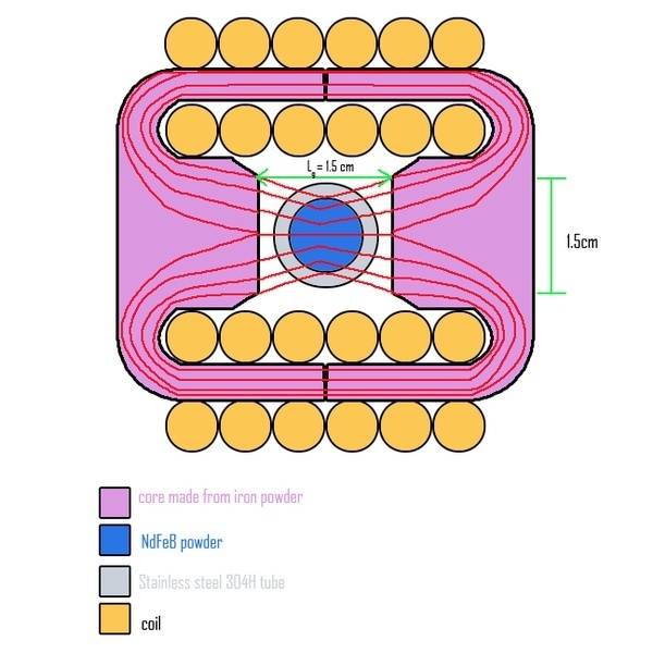

Hi trini-
I like your coil configuration in post #58 better than #59, because there will be less flux leakage, which will literally defeat some good dipole magnet designs, which are made with higher relative permeabilities.
Your #58 design is called an H-magnet design, and the powdered iron funnels the flux around a bend into the sample, where the H-field (but not necessarily the B field) is concentrated. Do you plan to slide the sample in/out or do you plan on removing ferrite to get the sample in/out?
In any case, the powdered iron/ferrite will saturate before you get to 1.4 Tesla, and there are few alternatives to adding brute-force amp turns.
The best possible design might be a cylindrical version of an H magnet (similar to a gapped pot core), with a gap in the center for the sample, and the sample surrounded by the coil. This would get the coil close to the sample, but it would have to be disassembled (like pot cores) to get the sample out.
You can minimize the size (max the Ga. #) of the wire in your coil by picking a wire size, and then integrating the current-squared times wire resistance over time:
E = ∫I2R dt (energy dissipated in wire during single pulse)
and choose a wire gauge such that the temperature rise in one pulse raises the copper temperature say 25 to 50 degrees.
Remember that the powdered iron raises both the magnetic field intensity and the inductance of the coil.
Bob S.
  • #61
Bob's got a good proposal - The gap through the Neo is HUGE. When your magnet material goes into saturation, you'll have terrible problems with leakage flux. The best way to attack that is to have the coils in closest proximity to the Neo.

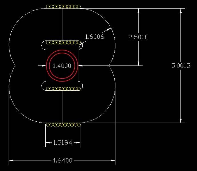

Ok so more tinkering has led me to this. I can't use a pot core because of my magnet shape, but this is essentially the same thing. I have employed rounded edges wherever possible to avoid flux leakage, while the M shape of each half of the core serves to direct the lines to the gap. The tube is relatively impermeable compared to the neo so it itself provides a natural 2mm gap i have to deal with on each side of the neo. I call it a MoM core, see if you can guess why ;)
  • #63
You don't really need or intend 0.0001 tolerances do you?
  • #64
no no autocad automatically does that, i'll round off to suit.
