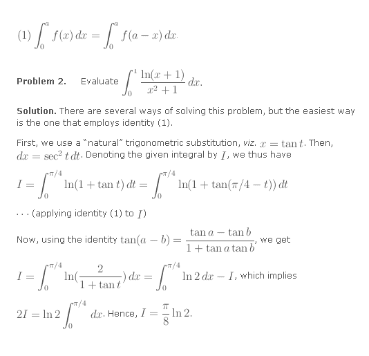

I'm stuck with this definite integral : \int_0^1\frac{ln(1+x)}{1+x^{2}} dx
The various "standard integrals".
I just don't know where to start, or how to do it. I tried various substitutions but none of them worked; I also tired doing it by parts but that didn't work either.
Okay, I got that. Thanks.
I knew of the identity, but didn't know I'd have to use it after making a substitution.
