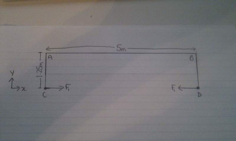

Calculate the force F1 to bend the beam AB to a radius of 7.5m. Assume the beam is a steel tube 200mm OD with wall thickness 20mm. The arm's AC and BD can be assumed rigid.
The force F1 acts on pivots at C and D and is always in the x direction.
I = pi (do4 - di4) / 64
My first thought was to assume the beam was fixed at one end and then work out the deflection required to achieve a a radius of 7.5m. From this I substituted into the deflection formula to work out a point load need on the end of the cantilevered beam to produce the deflection.
I think i should be calculating the moment at point C and D but I'm struggling a bit, any help would be greatly appreciated.

Why not just use
M/I = σ/y = E/R
E is given for the material and you know R. Just get M.
Thanks rock.freak667.
i have since found this formula and came out with an answer of 1.25 x 10^6 N/m for the moment required.
this is using a value of 4.637 x 10^-5 for the second moment of area and a young's modulus of 200GPa for the steel.
As the arms at the end of the beam are 1.25m long then the required force at points C and D would be 9.9 x 10^5 N.
This seem a little high?
When I calculated the second moment of area I got 2.701*10^-5 m^4 based on this:
I=\frac{\pi*\left[\left(200mm\right)^{4}-\left(200mm-20mm\right)^{4}\right]}{64}=2.701\times10^{-5}m^{4}
This would change your results a little bit. Solving out the ratio before of M/I = E/R gives:
\frac{M}{I}=\frac{E}{R}
M=\frac{EI}{R}
M=1.441\times10^{5}N
I would definitely double check what I did. 32,394 pounds of force seems reasonable to me though.
