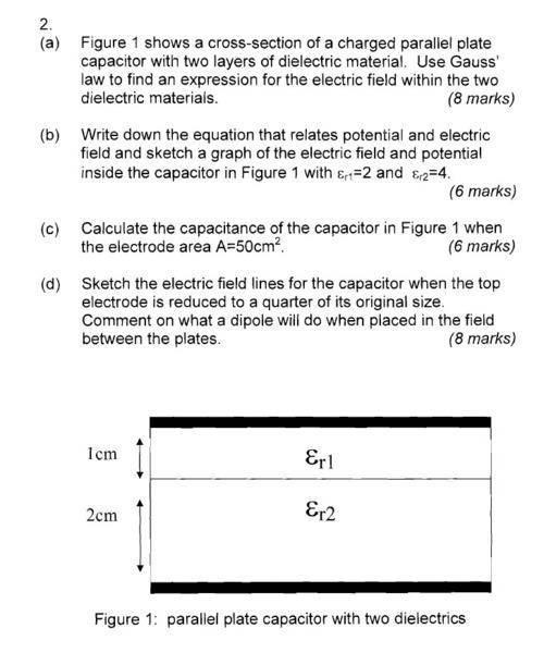

Use Gauss' law to find an expression for the electric field within a charged parallel plate capacitor with two layers of dielectric materials (?r1 and ?r2).
(See attached image, this is for question 2a).
My approach would be to split the capacitor into two capacitors, each with r1 and r2 dielectrics - connected in series. Then the electric field across them both would be the sum of the electric fields across each one?
So:
For The first dielectric:
The integral of: E1.dA = Q/(e0*er1)
E1 = Q/(e0*er1*A)
E2 = Q/(e0*er2*A)
Therefore
Etotal = (Q/(?0*A)) * (1/?r1 + 1/?r2)
Am I taking the right approach?
Any help would be appreciated,
Thanks.

Just had a brain wave: is it possible to treat both dielectrics as a single material by averaging their respective permittivities divided by their proportion of the gap?
So
\epsilon_{T}=\epsilon_{r1}*1/3 + \epsilon_{r2}*2/3 = (\epsilon_{r1} +2\epsilon_{r2})/3
Therefore:
E = 3Q/(A\epsilon_{0}(\epsilon_{r1}+2\epsilon_{r2}))
This seems more likely... I think...
