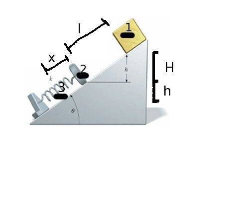

A block of mass m starts from rest at a height h and slides down a frictionless plane inclined at angle θ with the horizontal, as shown below. The block strikes a spring of force constant k.
Find the distance the spring is compressed when the block momentarily stops. (Let the distance the block slides before striking the spring be l. Use the following as necessary: m, θ, k, l, and g.)

My Diagram:
Let H = l*sinθ
Let h = x*sinθ
Moment 1: E = mg(H+h) = mgsinθ(l+ x)
Moment 2: E = (1/2)mv2 + mgh = (1/2)mv2 + mgx*sinθ
Moment 3: E = (1/2)kx2
-------- Attempts to get rid of x2 led to
x = h/sin
(1/2)k(h/sinθ)2 = mgsinθ(l+ x) ;;;
(kh2/2sin2θ) = mgsinθ(l+ x) ;;;
(kh2/2) = mglsin3θ + mgxsin3θ ;;;
(kh2/2) - mglsin3θ = mgxsin3θ ;;;
x = k*h2/2mgsin3θ - l

Don't try to express things in terms of "h"--that's an unknown directly related to "x".
Hint: Just compare moments 1 and 3. Solve that equation!
As h=xsinθ, your last equation does not give x explicitly in terms of the known quantities, k, m, θ, L, and g.
ehild
So by solving equations 1 and 3 I got
mglsinθ+mgxsinθ = (1/2)kx2
0 = (k/2)x2 - mgsinθx - mglsinθ
quadratic formula
x = (mgsinθ ± √[mgsinθ(mgsinθ+2kl)] ) / k
It is all right now.
