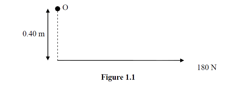

(a) Figure 1.1 illustrates a force of 180 N acting at a perpendicular distance of 0.40 m from a point O. Calculate the torque about O.

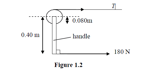

(b) Figure 1.2 illustrates a circular drum of radius 0.080 m around which a rope is wound. The drum is turned by means of a handle of length 0.40 m to which a force of 180 N is applied at right angles to the handle.
Calculate the tension T in the rope.

(a) Torque=Fr=180(0.4)=72Nm
(b) ƩT=0
0.08T-180(0.4)=0
T=180(0.4)/0.08=900 Nm

Your a) and b) answers are right. What's your thinking on c)?
i am trying to figure out the free body diagram for part c
