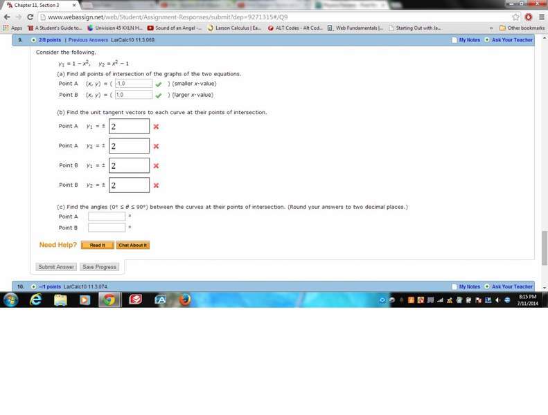

For the equations:
y1 = 1-x^2
y2 = x^2 -1
find the unit tangent vectors to each curve at their point of intersection.
d/dx (y1) = -2x
d/dx (y2) = 2x
After solving for points of intersection between the two equations (-1,0) & (1, 0), I proceeded to ask the derivative for the slope of these points.
The slope at x = 1:
for y1 = -2j
for y2 = 2j
The slope at x = -1:
for y1 = 2j
for y2 = -2j
Next, I divided each resultant vector by the magnitude, (2), to obtain the unit vector.
However, this appears to be incorrect, and I am not sure why.
Attached is a photo:

Slopes are not vectors. The slopes are 2 and -2 which are scalars. To get a vector along a tangent line of slope 2, figure out a ##\Delta y## and ##\Delta x## such that ##\frac{\Delta y}{\Delta x}=2## and make a unit vector out of ##\Delta x i + \Delta y j##.
Likes 1 person
Ahhh. Yes. Of course. Took me a minute to think about it ^.^
