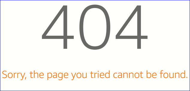

OCR said:
" source " doesn't seem to go very far for me. . . . 🙄
Yes, defeated by deep linking/country of origin/some other protection I suppose. Well anyone that wants it badly enough can track it down on AWS...
That's because the tag for PF is on the tail of the link. It works if you leave off the "/&tag==pfamazon01-20/"
and just use
https://aws.amazon.com/ec2/pricing/on-demand/&tag=pfamazon01-20
Yeah. . . ✔
And, the Forum is misbehaving again. . .
OK, one more time. . .
https://aws.amazon.com/ec2/pricing/on-demand/&tag=pfamazon01-20:oldlaugh:Carry on.
Sorry, it doesn't work. Still get a "404 Page Not Found" :frown:
Me too

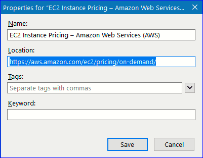

The forum is adding the tag to the link for revenue-raising purposes - it presumably does so for all amazon.com links including aws @Greg Bernhardt can you turn this off for the aws subdomain?
You can copy or type the URL https://aws.amazon.com/ec2/pricing/on-demand/ into the browser, or a link shortner may work: https://tinyurl.com/z7dt2tp.
Yeah, it is. . . ✔
That's what happened in post #24 . The link in post 24 was actually a bookmark to that site, and should have been
like this. . .
Notice the correct URL. . .Well, we've you've got that figured out. . . nice job. 👍
