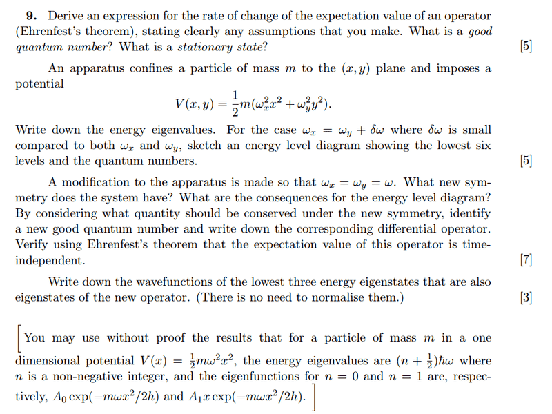

2D Harmonic Oscillator and Ehrenfest's Theorem
In summary, the conversation is about deriving Ehrenfest's Theorem and discussing good quantum numbers in a quantum system. The conversation also includes writing down energy eigenvalues and sketching energy diagrams, as well as discussing the symmetry and potential of the system and finding a new good quantum number and corresponding operator. Finally, the conversation touches on energy eigenstates and their potential changes.
unscientific
1,734
Part (a): Derive Ehrenfest's Theorem. What is a good quantum number?
Part (b): Write down the energy eigenvalues and sketch energy diagram showing first 6 levels.
Part (c): What's the symmetry of the new system and what happens to energy levels? Find a new good quantum number and corresponding operator. Use Ehrenfest's to show it is true.
Part (d): Write down the new wavefunctions.

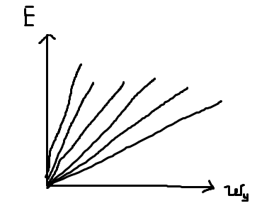

And how do I sketch the energy levels? Is it simply:

Ok, so I can't ignore ##\delta \omega##. So all the graphs should be slightly more steep in the plot.
For part (c), when ##\omega_x = \omega_y## The graphs become less steep, as the additional contribution due to ##delta \omega## is gone.
Is the new good quantum number ##n = n_x + n_y##? So the new differential operator is the total hamiltonian ##-\frac{\hbar^2}{2m} \nabla^2 + m\omega^2(x^2 + y^2)##?
For some reason you have plotted ##E## vs ##\omega_y##?
You also left off the quantum numbers.

The energy is is a function of ##\omega_y##:
[tex]E = \hbar \omega_y(n_x + n_y +1) + (n_x + \frac{1}{2})\hbar \delta \omega[/tex]
Look in your text for an energy level diagram - do the energy level lines slope like your's do?
Aside - if ##\omega_y=0## what is ##E_{n_x,n_y}##? Compare with what you sketched.
Oh the graphs are V against x, quadratic in shape.
That is the shape of the potential - what shape are the energy levels shown on those graphs?
Are they sloping lines? I suspect you'll find they are drawn horizontally yes?
If you look at the labels for the energy eigenvalues for each energy - how do they handle the angular frequency dependence?
Yeah, the levels are horizontal lines, since for a given n, energy is fixed:

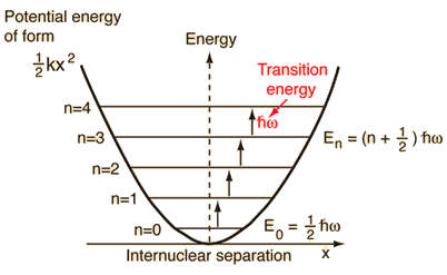

Energy level diagrams:
Notice how the angular frequency of the energy eigenvalues is treated?
They just put it in the expression for the value.
I think this is the sort of diagram you are expected to draw.
But it is your course and your course notes may have included diagrams like what you drew calling themselves energy-level diagrams ... but that would not be the usual convention.
