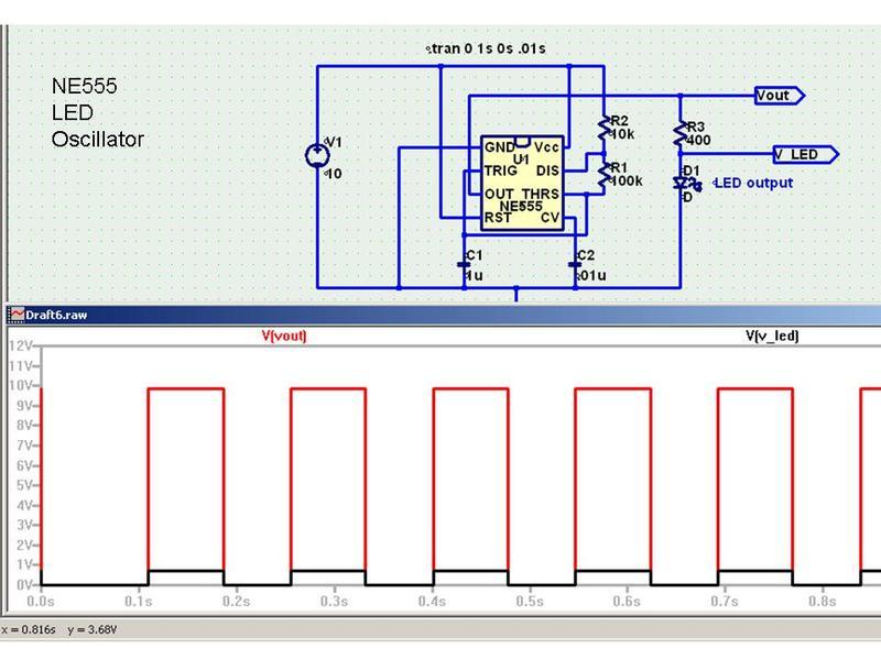

As far as I can tell, nobody has posted any schematic of a NE555 LED oscillator. So I built one in 15 minutes (in LTSpice) and turned it on. Here it is...
