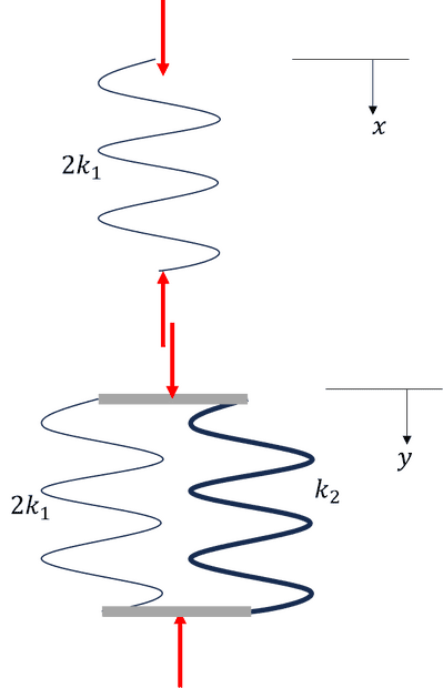

A block dropped onto a spring system as shown in the figure. If the spring constant of the longer spring is mg/2h then find the spring constant of the larger.
Work done= change in kinetic energy
Consider this situation. A mass $$m$$ is dropped onto the spring system from rest , and it is given that the smaller spring gets compressed by a distance $$h$$
My main query in this question is regarding the use of Work Energy theorem, which states that the work done on a body by all the forces acting on it is equal to the change in its kinetic energy.
Additionally it is given that the spring constant of the longer spring is $$mg/2h$$.
Now, applying Work Energy theorem between the top point and the bottom, we get:
$$ 0= 2mgh -(mg/2h) (4h^2 /2) - k_2 h^2 /2 $$
Here the first term is the work done by gravity, second the work done by the longer spring, and third the work done by the smaller spring.
Solving, we get $$ k_2 = 4mg/h $$
However, my main problem is while trying to apply work energy theorem between the point B and A.
I decided to try a different approach to this problem and began by using Work Energy theorem between the top point and B
This gave
$$ Mv_b ^2 /2 = 2mgh- (mg/2h)(h^2 /2) $$
Solving this, I get $$KE_B= 7mgh/4 $$
Now comes the problem. Applying Work Energy theorem between B and the bottom point, I get
$$ 0- 7mgh/4 = W_{sp1} + W_{sp2} + W_g$$
$$ -7mgh/4 =-(mg/2h)h^2/2 - (k_2)( h^2/2) + mgh$$
**Now solving for k_2**,
$$k_2= 5mg/h $$
**Why is there this subtle difference?**
Has there been a misunderstanding or incorrect application of work energy theorem?
Which one is right.
And why?

The diagram appears to show a long spring at two different lengths, y and h+y, where y is the height of B above ground and is not given but appears to be less than y; and a short spring of length y only.
So it looks as though the mass falls 2h, the long spring becomes compressed by h and the short spring not at all.
But you state that the shorter spring is compressed by h, so I'll assume the diagram is inaccurate and anyway does not show the final state. This means the total distance fallen is 3h.
According to your equation, the mass comes to a stop after falling 2h and at that point the long spring has been compressed 2h while the short spring has been compressed h.
I can think of no interpretation of the diagram which matches that.

Your work done by the longer spring between B and the bottom is incorrect. You have computed it as if the spring was relaxed at B, but it is already stretched at that point.
Generally, of course taking the work-energy between drop point and B and then between B and the bottom must be equivalent to taking it directly between drop point and bottom. Introducing the velocity at B and doing the double application or the WE theorem just introduces the double amount of places where things can go wrong. So unless you are actually looking for the velocity at B I would strongly advice against it.

Thank you so much. I cemetery neglected the fact that b also stretches. Now I get why I was incorrect.

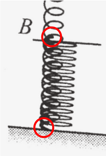

Ok, but I still am unclear on the set up.
In my interpretation,
  1. the mass free falls distance h
  2. it hits the taller spring and compresses it by h. The mass has now descended 2h. At this point it contacts the shorter spring.
  3. the mass descends a further h before coming to an instantaneous stop. At this point, the mass has descended 3h, the tall spring has compressed by 2h, and the shorter by h.
Is this correct? If not, please state it in similar detail.
Seems like we all aren't on the same page.
I'm thinking that based on the diagram the short spring is fixed to the long spring at its midpoint making it a "spring system" where if the long spring compressed by ##h## by the falling mass the short spring compresses by ##\frac{h}{2}##.
If the springs were independent and the long spring compresses by ##h## then the other short spring appears to do nothing if the diagram is correct. So I'm not leaning that way.
This is assuming that the shorter spring is attached to the midpoint of the longer one, information that we are not given (the distance to the floor is not available in the figure).
The object is said to fall ##h## below the end point of the thicker spring (i.e., B). This is also what the OP is seemingly attempting to use for the solution. In this case, the elongation of the longer spring is ##2h## and that of the thicker spring is ##h## at the point of maximal compression so the thicker spring definitely does something.
That said, the problem could be clearer formulated.
Edit: The issue of the OP's first solution is that they consider the fall distance to be ##2h## and not ##3h## as they should. They are doing the compressions of the springs as if the fall distance were ##3h## so that the longer spring is compressed by ##2h## and the shorter by ##h##. The issue of the second solution is that they are miscalculating the work done by the longer spring from point B to the lowest point. Both therefore result in the wrong answer.

Well, the diagram is horrible then, because compressing ##h## below B puts the mass below ground and our spring system have dematerialized.
Never assume diagrams are to scale unless explicitly stated. This issue exists also in your interpretation as the statement says that the smaller spring is compressed by ##h##.
