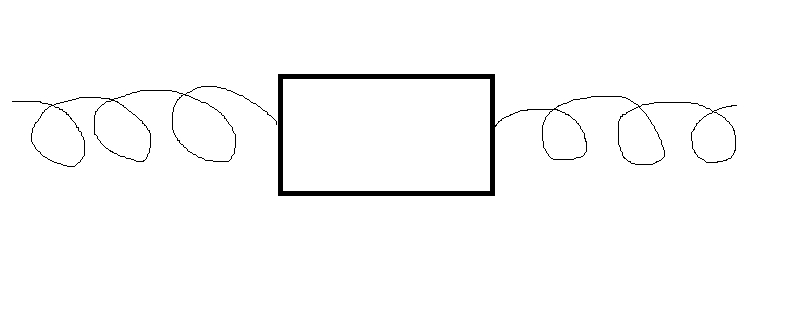

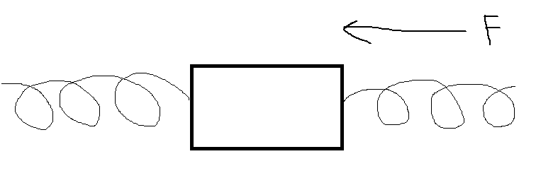

I'm having trouble visualizing what is going on in this problem. I imagine that the box is in a position like this with a spring on each end of the box. Then a force F is applied that compresses the springs. What I'm wondering is: How does the force parallel to the springs compresses both springs? It would seem that one would be compressed, while the other would not be effected.
Diagram of a rectangular block on a horizontal surface with a coiled spring attached to each side, and a leftward arrow labelled F above the right side.
  • Diagram of a rectangular box on a surface with a coiled spring attached to the left side and another coiled spring attached to the right side.

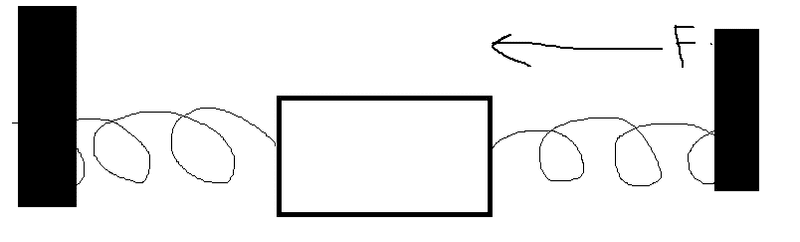

The springs are attached to the box, so if the box moves, the attached ends of the springs move with it. The outer ends of the springs are clamped to some fixed supports. So when the box moves, one spring is compressed while the other is stretched.

So more like this? Where the black rectangles are the supports?
Diagram of a rectangular block between two black wall supports, connected to each support by a coiled spring, with a leftward arrow labelled F pointing from the right.
