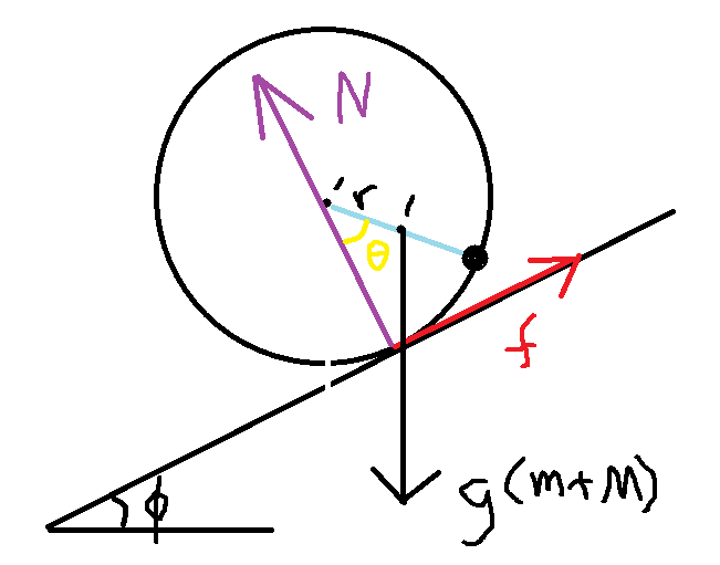

A thin rod of mass m is welded on inner surface of a thin-walled pipe of mass M parallel to the axis of the pipe. The composite body thus formed is placed on a uniform slope as in the figure. Inclination of the slope is adjustable. Find range of coefficient of friction between the pipe and the slope for which the body slides down without rotation.
Torque
Here is the hint that the book gave me:
"For the maximum value of μ, the rod must be to the extreme right i.e. horizontally rightwards of the axis of the pipe"
I think what it meant is the same as this:
Note: in the calculation below, ##r## is the distance from the center of pipe to the CoM of the system and ##r = mR/(m+M)##
So, the torque calculation (with the system's CoM as origin) for maximum μ will be :
##N r = f R##
##Nr=NμR##
##m/(m+M)=μ##
But, the book says that it is ##m/\sqrt{M(M+2m)}##
Where did I do wrong?

I would start with this picture
torque wrt CoM: torque from normal force = Nrsinθ = torque from friction force = μN*L
Find L as an expression of r and θ
Likes Delta2 and Rikudo

Look at the pic above, try to calculate µ as a function of θ
@Rikudo now picture is correct...
AH! Now I got it. Thanks!

For information, the hint says:
"For the maximum value of μ, the rod must be to the extreme right i.e. horizontally rightwards of the axis of the pipe"​
But in your diagram, the rod (red dot) is not at the extreme right, and therefore not at the same horizontal level (i.e. not at the same height) as the axis of the pipe.
Likes Lnewqban and malawi_glenn
That's OK. One can find ##\mu## at some angle ##\varphi## below the horizontal line and then maximize ##\mu## with respect to ##\varphi##. Just a little bit more work, but that's what I did to explore what ##\mu## looks like as a function of ##\varphi.##
