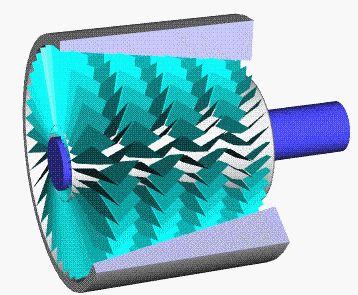

i think you are wrong, blades from turbine has force pointing backwards,so forces at blades of turbine and compressor act in opposite direction,just force on compressor is greater .
thrust=force at compressor - force at turibne
see in animation lift is pointg backawards on turbine blades (2:22sec)
http://aeromodelbasic.blogspot.com/2012/05/thrust-distribution-distribution-of.html
i understand compressor has foraward thrust and turbine and nozzel has reward thrust.
but how diffuser and combustion chamber can produce forward thrust??
i think that diffuser produce rearward thrust,because walls from diffuser are facing backwards and pressure allways act prependicular to the surface.
I may be wrong, as many times before. :smile:
It seems to me that the orientation of the blades of that compressor in the animation has been incorrectly represented.
Nevertheless, consider these factors conditioning the shape of those blades:
1) The turbine is extracting all useful work it can from the stream of combustion gases: those blades are being driven.
2) The compressor is giving all work it can to the stream of incoming air: those blades are driving a compressible fluid.

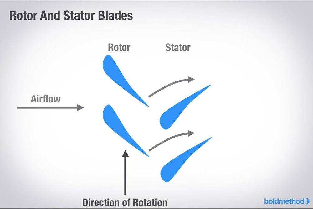

Most illustrations of axial turbines show only the rotor blades. Actually, between each row of rotor blades is a set of non-rotating stator blades. They don't show them in most illustrations because having both makes both the rotor and stator blades impossible to see. Look carefully at that animated gif. You see alternating rotating and non-rotating blades.
You don't want the full thrust on the rotor, because it would need a big thrust bearing to handle it. So low, or neutral thrust on the rotor is desirable. However, all those stator blades are fixed to the airframe so they can carry thrust.
I'm not saying that the stator carries all the thrust, your illustration with the ramjet clearly shows that you can make thrust with no turbine at all.
yes stator "wings" lift vector is pointing slighty forward so they also add some thrust

I don't think that's necessarily equivalent though. In this case, there's energy addition happening between the compressor and turbine, and as a result, the pressure rise through the compressor is actually higher than the pressure drop through the turbine, and based on this, I'd actually expect a net forward thrust on the spool overall. I suppose you could probably move some of this force around based on clever shaping of rotor vs stator stages (effectively, transferring thrust to the stators rather than the rotors), but I'd definitely expect a larger net forward force on the compressor than the net backwards force on the turbine.
Then again, the diagram above in post 6 seems to indicate that it's actually the other way around, and I guess I could envision that too, since the flow area through the turbine will be larger than the flow area through the compressor at equivalent pressure levels. This larger flow area means larger turbine blade area than compressor blade area (again at equivalent pressure areas), which would tend to cause a larger backwards load on the turbine than forwards load on the compressor. For a turbofan though, the fan load would be pulling the other way, and might be enough to bias the overall load forwards again.
Basically, there's no reason the force has to be balanced due to the energy addition, but I could see it ending up approximately balanced depending on how you set up the internals. I haven't looked at jets in detail since my propulsion class in grad school back in 2011 though, so I'm definitely a bit rusty.
The diagram also indicates that the combustion chamber has a "thrust" on it far exceeding the thrust on the compressor or turbine, at first impressions for anyone looking at it, but that is completely incorrect. The chamber does not support a mechanical load., and there is no static pressure rise through the chamber, but a velocity increase.
The labeling in that picture is deceiving.
The chamber could have a thrust - if there's an area increase from front to back (which is very likely, given the expansion as heat is added), you'll have a force imbalance even though the pressure is constant throughout (actually a slight pressure loss, but this is often neglected in simple analysis).
