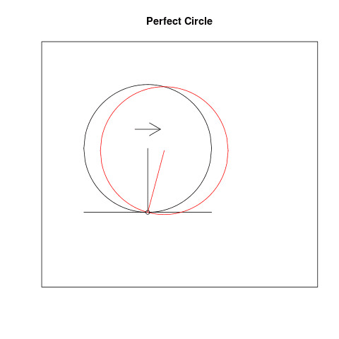

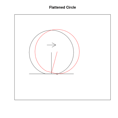

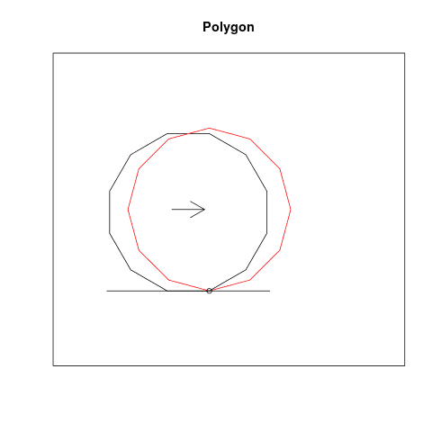

I promised some pictures earlier, and I've finally made them. Here are three pictures, showing a wheel rotating around a point of contact with the ground. The first is a perfectly circular wheel, the second is a wheel with the bottom flattened (eg a tyre compressing under the weight of the load) and the third is a polygon.
We see that, if the wheel rotates around the foremost point of contact in the direction of travel (marked) through a non-zero angle, it all works OK for the polygon and the flattened wheel, but not for the perfect circle, which has to go below the floor.
The answer arrived at in the thread above is that there is no rotation through any angle about that point. Rather, the statement that the wheel is rotating about that point is just a description of the instantaneous relative velocities of points on the wheel.

If the polygon is allowed to lift itself up why not the round wheel?
No, because the contact point is also moving along the circumference of the wheel. Look at your other drawings, you allowed the contact point to move in order for the wheel to stay above the floor in those cases, so why not for the circular wheel as well?
This is rotation around a point stationary w.r.t. ground. The contact point of a rolling wheel is not stationary w.r.t. ground.

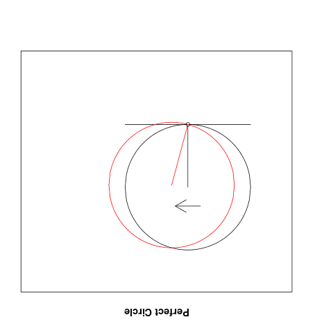

Here I have flipped the one picture upside down. Here we see a circle of very large radius ( so that the surface approaches a flat plane ) rolling on a another surface of negative curvature ( a circle ). I would tend to think that the "plane" does not penetrate the circle as it moves around. Other scenarios of interacting surfaces of positive and negative curvature could be investigated, as either 'chord length model' or 'continuum model'.
At least that is how I see the disclosed problem. Not sure if that is what you had in mind.
Note that your polygon will go below the floor too, when you fail to shift the rotation center forward (rotate around the previous corner). This is what you do with the circle here.
