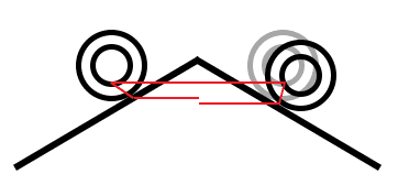

andrewkirk said:I promised some pictures earlier, and I've finally made them. Here are three pictures, showing a wheel rotating around a point of contact with the ground. ...snip..
View attachment 215189 View attachment 215190 View attachment 215191
You have shown the point of contact of the polygon on the right hand side. What happens when the polygon changes direction? Presumably you would move it to the left?
Why do you allow the point of contact to move around the perimeter of the polygon but not move around the perimeter of the circle?
