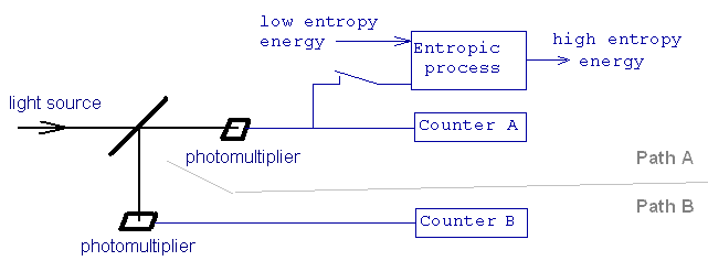

Just to be on the same page, here is the schematic illustration of the experiment:
-- Dmtr

Maybe I am nitpicking now, but there is a path missing from your schematic. If want to do a full QM analysis you need to include the vacuum "entering" from the top; a beam splitter always has two inputs and two outputs.
It is still not clear what you mean by "entropic process"? Do you simply mean that the system includes some form of ohmic bath?

In the real-life setup that would be an electric heater. But I guess in this thought experiment it can be zeroing the memory (which requires a corresponding increase in the entropy of the environment / Landauer's principle).
So there would be some extra decoherence due to the vacuum noise, right? And it could slightly diminish differences between the counters values in the experiment (3)? Well, I don't know if there would be any differences in the first place...

Here is another diagram, illustrating the entropy exchange with the environment:
-- Dmtr
