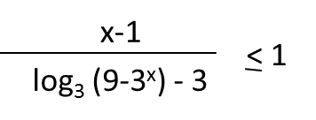

i got stuck at the question below:-
Fraction (x-1) over log base 3 of (9-3^x) minus 3, followed by the inequality sign less than or equal to 1.

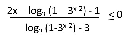

I tried to solve it by simplifying it but i got stuck at:-
Fraction inequality: numerator 2x - log base 3 of (1 - 3^(x-2)) - 1, denominator log base 3 of (1 - 3^(x-2)) - 3, the fraction is less than or equal to 0.

Hi Pranav-Arora! :smile:
Just simplify the bottom …
what is the difference between log3(9 - 3x) and log3(1 - 3x-2) ? :wink:
Sorry! Didn't get you...
One method for solving an inequality is to solve the associated equation; in this case that's
[tex]\frac{x-1}{\log_3(9-3^x)-3}=1[/tex].
Then the critical numbers are the solution set and any points of discontinuity.
Use test points (in the domain of the left hand side of the inequality) which either to the laeft or right of all the test points or between any pair of test point.
By the way, what is log3(9(1-3x-2)) ?
i think i forgot to mention, i need to find out the values of x.
what is log3(9 - 3x) - log3(1 - 3x-2) ? :wink:
It would be
9 - 3x
1 - 3x-2
But why i need to find this?
Try graphing [tex]\frac{x-1}{\log_3(9-3^x)-3}[/tex] or [tex]\frac{x-1}{\log_3(9-3^x)-3}-1\,.[/tex]
Remember that [tex]\log_3(a)=\frac{\ln(a)}{\ln(3)}[/tex]
Whoops! i forgot it:-
I converted everything in log and then i was able to figure it out.
Thanks SammyS...:)
