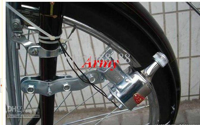

Have you seen the old bicycle headlight dynamos that had a small wheel that was held up against the bicycle tire to generate the electricity for the headlight? It made pedalling the bike harder, but you did not need to recharge your light every night. I'll post a pic if I can find one...
I'll also edit your thread title to be more accurate for the question you are asking. You set off the Free Energy / Over Unity / Perpetual Motion Machine detectors with your current title... :smile:
Like this one:
http://image.dhgate.com/albu_254428029_00/1.0x0.jpg
The kind of dynamo that gets its power by friction against the tyre is convenient to mount on any bike (which is an advantage) but a far more efficient arrangement is the 'Dynohub' style of alternator that uses a static coil and strong permanent magnets mounted inside a cylindrical. This link is from a real enthusiast!
