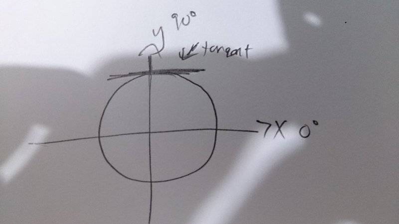

As the angle is rotated anticlockwise , so the tangent at here pointing to the left ? Pls refer to the photo below ?

  • #38
Yes. It is pointing in the negative x direction. It is thus equal to ##-\vec{i}##, where ##\vec{i}## is the cartesian unit vector in the (positive) x direction.
