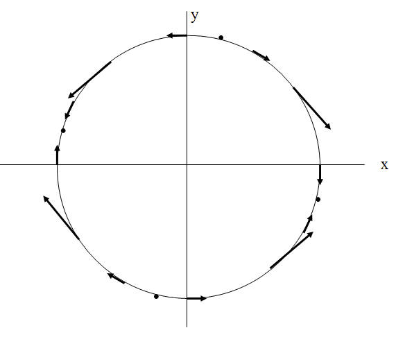

Perhaps this will help. For the state of stress shown in the present problem (assumed to also be a homogeneous state of stress), here is a sketch of the variation of the actual shear stress vectors acting on a cylinder of the material (i.e., exerted by the material outside the cylinder on the surface of the cylinder). The small arrows correspond to a shear stress of magnitude 30 MPa. The large arrows correspond to a shear stress magnitude of 90 MPa. The dots correspond to a shear stress of magnitude 0 MPa, and are situated at the directions corresponding to the principal stresses.
The large arrow in the lower right quadrant corresponds to the maximum shear stress vector at -55 degrees (i.e., it is tangent to the cylinder at -55 degrees). The large arrow in the upper right quadrant corresponds to the maximum shear stress vector at +35 degrees (i.e., it is tangent to the cylinder at +35 degrees). Note that the shear stress vector is varying in magnitude and direction over the surface of the cylinder.
Please study the figure carefully and see what you think. This is what the real shear stress distribution looks like, not the confusing picture provided by the Mohr circle.

This should be $$\theta_p =35.3\ degrees$$ ??
So , the maxiumum shear stress occur at $$\theta_p =-55\ degrees$$ ??

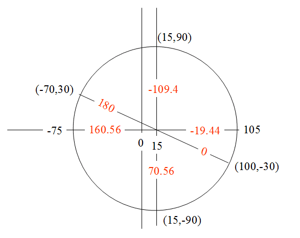

Can you plot the point of normal stress and shear stress on mohr's circle ? I want to compare ..
I have done in post #1 , but what i get from the mohr's circle is when i rotate the element 35 clockwise , i will get positive max shear stress of 90MPa , instead by calculation , the max positive shear stress at the angle of -55 degree.
So , what's wrogn with the mohr's circle i sketched ?

In this diagram , you assume the positive max shear stress is downwards ?
Both are correct. See my figure of the actual stress distribution.

Here is my Mohr's circle.
The numbers in red are the values of ##2\theta##. They run from -180 degrees to +180 degrees.
fonseh said:
In the digram , it's clear that at (100,30) , we only need to rotate the (100,30) to upper vertical axis to get the max shear stress , so how could the angle 2 theta > 90 degree ?
The figure clearly shows that ##\tau_{xy}=-30 MPa##, not +30 MPa. Redo the problem with that value and see what you get.

well , thanks for the diagram , can you explain why for the 100 , you plot the shear stress as negative 30 ? why for the 70 , the shear stress is positive 30 ?
See my post #13. For 70, the shear stress is ##-30\vec{i}=+30(\vec{-i})## (see my figure). The polar angle ##\vec{i}_{\theta}## is always oriented counterclockwise. The vectorial shear stress component in this framework is represented by ##\vec{\tau}=\sigma_t \vec{i}_{\theta}##.

can you explain why at ##\theta = 90## degrees, ##\vec{i}_\theta=-\vec{i}## ??
Chestermiller said:
No. What I'm saying is that, when we apply this specific framework, we are essentially expressing the stress vector in terms of its components in cylindrical coordinates. The normal stress is essentially ##\sigma_r## and the shear stress is essentially ##\sigma_{\theta}##. At zero degrees, the unit vector in the theta direction points in the y direction. At 90 degrees, the unit vector in the theta direction points in the negative x direction. At 180 degrees, the unit vector in the theta direction points in the negative y direction. At 270 degrees, the unit vector in the theta direction points in the positive x direction. So the unit vector in the theta direction is always pointing the the counterclockwise direction, and the sign of the shear stress value adjusts to this. So,
$$\vec{\sigma}=\sigma_n\vec{i}_n+\sigma_t\vec{i}_t=\sigma_r\vec{i}_r+\sigma_{\theta}\vec{i}_{\theta}$$
with $$\vec{i}_n=\vec{i}_r$$ $$\vec{i}_t=\vec{i}_{\theta}$$ $$\sigma_n=\sigma_r$$ and $$\sigma_t=\sigma_{\theta}$$
So , according to you , in the mohr's circle , you defined counterclockwise as positive , and the sign convention of the shear stress / force follow this also ?
So , for the point where the 100MPa tensile normal stress act , the shear stress will turn the element clockwise , so the shear stress has negative value ?
