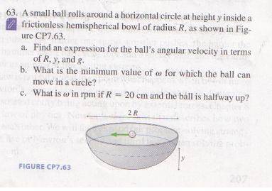

find an expression for the balls angular velocity in terms of R,y,and g
mr*omega^2=mg
so i had omega=sqrt(g/R) and I am saying that the angular velocity does not depend on its height. am i right?

oo its basically the picture.. "a small ball rolls arond a horizontal circle at height y inside a frictionless hemispherical bown of raidus R as shown in my picutre
find an expresion for the balls angular velo in terms of r,y,and g

As I guess the problem is of centripetal force.
Resolve the normal reaction of the bowl in horizontal and vertical direction.
the vertical component balances the weight and the horizontal component provides the required centripetal force. The ball is rotating in a horizontal circle of radius Rsinq(theeta)
q is the angle the radius of the bowl to the ball makes with verticle.
q is cos^-1(R-y / R)
The angular velocity depends on the height at which you want to revolve the ball. because with height the angle q will change and vertical component of the normal reaction will change accordingly.
you have equated centripetal force with the weight of the ball. How it is possible. The weight of the ball is acting vertically and the centripetal force is required horizontally.

Okay, let's call O is the center of thecircle at the top of the hemisphere.
A is where the object is.
C is the center of the circle the object is moving arround.
\alpha is the angle OAC. You notice, when the object travels arround the circle, \alpha = const.
Since it's frictionless, there are 2 forces acting on the object : P, N.
In Oy - axis:
P = N\sin{\alpha}
The ball travels at the constant speed, and arround a circle (circular motion).
Therefore you also have:
N\cos{\alpha} = m \frac{v ^ 2}{r}
\Leftrightarrow v = \sqrt{\frac{N \cos \alpha r}{m}} = \sqrt{\frac{P \cos \alpha r}{\sin \alpha m}} = \sqrt{g r \cot \alpha}
r is the radius of the small circle the object is traveling arround.
All you have to do now is to calculate the r, and cot(alpha) with respect to R, and y.
Is that clear enough?
EDIT:
You can find the angular velocity by:
\omega = \frac{v}{r} = \sqrt{\frac{g \cot \alpha}{r}}
